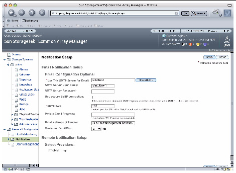

1. In the navigation pane, under General Configuration, choose Notification.
The following Notification Setup page is displayed.
a. Enter the name of the SMTP server.
If the host running this software has the sendmail daemon running, you can accept the default server, localhost, or the name of this host in the required field.
b. Specify the other optional parameters, as desired.
c. If you have changed or entered any parameters, click Save.
d. (Optional) Click Test Local Email to test your local email setup by sending a test email.
If you need help on any of the fields, click the Help button.

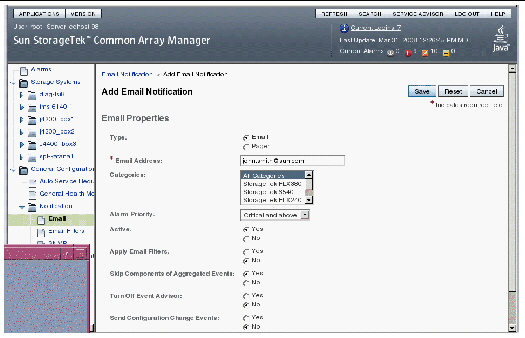

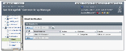

4. Set up local email notification recipients.
a. Click Administration > Notification > Email.
The following Email Notification page is displayed.
The following Add Email Notification page is displayed.
c. Enter an email address for local notification. At least one address is required to begin monitoring events. You can customize emails to specific severity, event type, or product type.

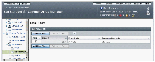

5. (Optional) Set up email filters to prevent email notification about specific events that occur frequently. You can still view filtered events in the event log.
a. Click Administration > Notification > Email Filters.
The following Email Filters page is displayed.

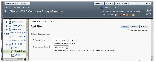

The following Add Filter page is displayed.
c. Enter the event code that you want to filter. You can obtain event codes from the Event Details page of the event you want to filter to prevent email notification for events with that event code.

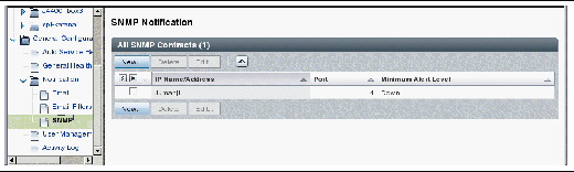

a. Click Administration > Notification > SNMP
The following SNMP Notification page is displayed.

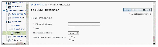

The Add SNMP Notification page is displayed.
c. Enter the following information

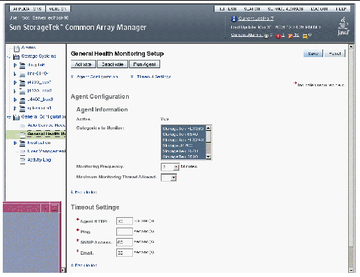

To enable array health monitoring, you must configure the Fault Management Service (FMS) agent, which probes devices. Events are generated with content, such as probable cause and recommended action, to help facilitate isolation to a single field-replaceable unit (FRU).
You must also enable array health monitoring for each array you want monitored.
1. In the navigation pane, expand General Configuration.
The navigation tree is expanded.
2. Choose General Health Monitoring.
The following General Health Monitoring Setup page is displayed.
3. Select the types of arrays that you want to monitor from the Categories to Monitor field. Use the shift key to select more than one array type.
4. Specify how often you want to monitor the arrays by selecting a value in the Monitoring Frequency field.
5. Specify the maximum number of arrays to monitor concurrently by selecting a value in the Maximum Monitoring Thread field.
6. In the Timeout Setting section, set the agent timeout settings.
The default timeout settings are appropriate for most storage area network (SAN) devices. However, network latencies, I/O loads, and other device and network characteristics may require that you customize these settings to meet your configuration requirements. Click in the value field for the parameter and enter the new value.
7. When all required changes are complete, click Save.

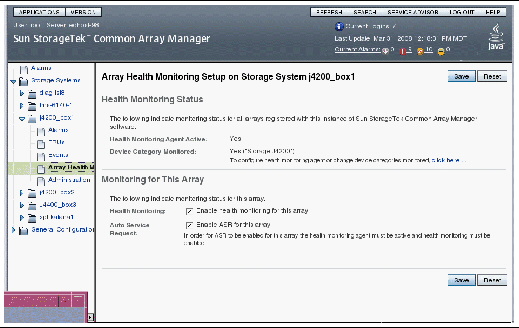

1. In the navigation pane, select an array for which you want to display or edit the health monitoring status.
2. Click Array Health Monitoring
The following Array Health Monitoring Setup page is displayed.
3. For the array to be monitored, ensure that the monitoring agent is active and that the Device Category Monitored is set to Yes. If not, go to Configuring Array Health Monitoring
4. Select the checkbox next to Health Monitoring to enable health monitoring for this array; deselect the checkbox to disable health monitoring for the array.

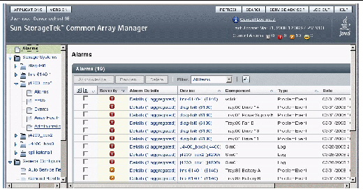

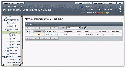

You can display alarms for all arrays listed or for an individual array. Events are listed for each array only.
1. To display alarms for all registered arrays, in the navigation pane, choose Alarms.
The following Alarm Summary page for all arrays is displayed.
2. To display alarms that apply to an individual array, in the navigation pane select the array whose alarms you want to view and choose Alarms below it.
The following Alarm Summary page for that array is displayed.

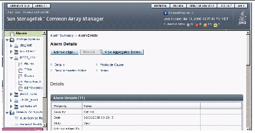

3. To view detailed information about an alarm, in the Alarm Summary page, click Details for the alarm.
The following Alarm Details page is displayed.

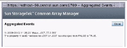

4. To view the a list of events associated with an alarm, from the Alarm Details page, click Aggregated Events.
The following Aggregated Events page is displayed.

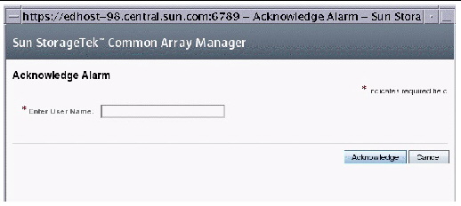

2. Select the check box for each alarm you want to acknowledge, and click Acknowledge.
The following Acknowledge Alarms confirmation window is displayed.
3. Enter an identifying name to be associated with this action, and click Acknowledge.
The Alarm Summary page is redisplayed, and the state of the acknowledged alarms is displayed as Acknowledged.

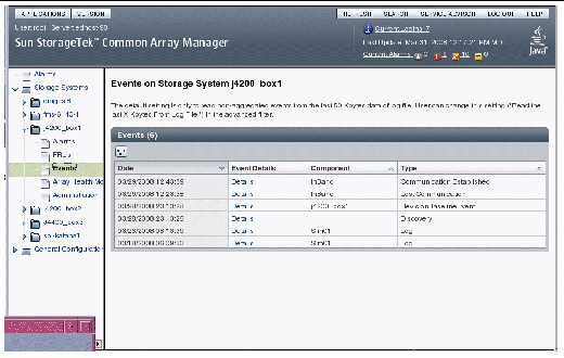

To gather additional information about an alarm, you can display the event log to view the underlying events on which the alarm is based.
1. In the navigation pane select the array for which you want to view the event log and choose Events.
The following Events page displays.

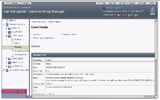

2. To see detailed information about an event, click Details in the row that corresponds to the event.
The Event Details page is displayed for the selected event.

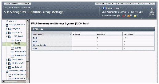

1. In the navigation pane, select the array whose FRUs you want to list and click FRUs.
The FRU Summary page is displayed. It lists the FRU types available and provides basic information about the FRUs. The types of FRU components available depend on the model of your array.
The following figure shows the FRU Summary page for the Sun Storage J4200 array.

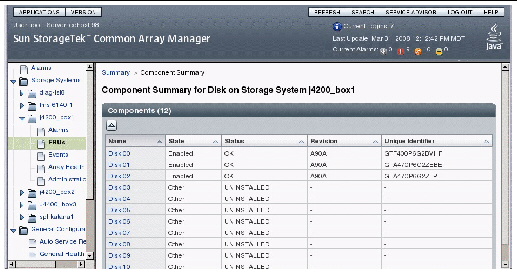

2. To view the list of FRU components of a particular type, click on name of the FRU in the FRU Type column.
The Component Summary page displays the list of FRUs available, along with basic information about each FRU component.

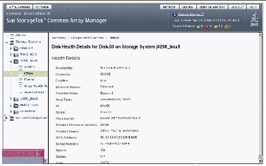

3. To view detailed health information about a particular FRU component, click on the component name.
Depending on the FRU type of the selected component, one of the following pages will display:
The disk drives are used to store data. For detailed information about the disk drives and each of its components, refer to the hardware documentation for your array.
The following figure shows the Disk Health Detail page.

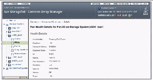

The fans in the Sun Storage J4000 Array Family circulate air inside the tray. Some array models, such as the J4200 array, contains two hot-swappable fans to provide redundant cooling. Other array models, such as the J4400, include fans in the power supplies. For detailed information, consult the hardware installation guide for your array.
The following figure shows the Fan Health Detail page.

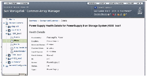

Each tray in an array has hot-swappable, redundant power supplies. If one power supply is turned off or malfunctions, the other power supply maintains electrical power to the array.
The following figure shows the Power Supply Health Detail page.

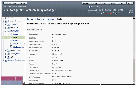

The SAS Interface Module (SIM) is a hot-swappable board that contains two SAS outbound connectors, one SAS inbound connector, and one serial management port. The serial management port is reserved for Sun Service personnel only.
The following figure shows the SIM Health Detail page.

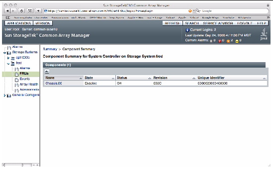

The system controller is available as part of the Sun Storage J4500 array. The system controller is a hot-swappable board that contains four LSI SAS x36 expanders. These expanders provide a redundant set of independent SAS fabrics (two expanders per fabric), enabling two paths to the array’s disk drives. The serial management is reserved for Sun Service personnel only.
For more information about the system controller, refer to the hardware documentation for your array.
The following figure shows the Component Summary for the System Controller page.

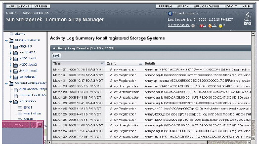

The activity log lists user-initiated actions performed for all registered arrays, in chronological order. These actions may have been initiated through either the Sun StorageTek Common Array Manager or the command-line interface (CLI).
1. In the navigation pane, click General Configuration > Activity Log.
The Activity Log Summary page is displayed.

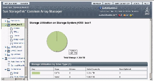

Common Array Manager graphically provides a summary of the total storage capacity of an array and the number of disk drives that provide that storage.
