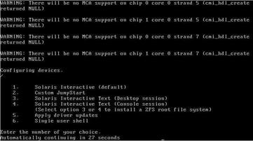

The system loads the Solaris disk image into memory. This process can take several minutes. When it completes, the Install Type menu appears.
Note - The screens that are displayed on your system might vary depending on the type of interface you chose to configure in Step 6. The following sample screens appearing in this procedure are based on the default Graphical User Interface (GUI) option (option 1).

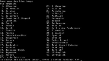

The system discovers and configures the devices and interfaces. If the system discovers a keyboard, the Configure Keyboard Layout menu appears.
The system configures the keyboard layout selection and searches for configuration files.

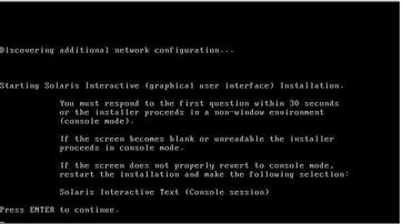

If you selected a GUI installation in the previous steps, the next two steps (Step 8 and Step 9) confirm that the GUI is functioning. If you did not select a GUI interface previously, skip to Step 10.
A second screen appears to confirm that the GUI is functioning.

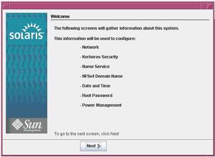

After a few moments the Welcome screen appears.
Note - The sample screen shown below reflects the GUI installation program. If you are running a text-based installation interface, the text-based Welcome screen (not shown) will appear.
If you preconfigured all of the system information, the installation program does not prompt you to enter any configuration information. If you did not preconfigure all the system information, the installation program prompts you for this information on several configuration screens.
Note - The screens that are displayed on your system might differ depending on the type of interface you chose to configure in Step 6. The sample screens appearing in this procedure are based on the default Graphical User Interface (GUI) option (option 1).
