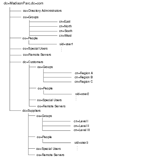

Marking Organizations
Script: update-o.pl
If you used an existing organization as your default organization during installation, you do not have to make these changes. The installation program automatically adds these object classes and attributes. Continue with Marking People Containers.
If you have sub-organizations or custom organizations, make the following changes:
In the MadisonParc example, these object classes and their attributes are added to the dc=Customers and dc=Suppliers organizations.

In Code Example 2-1, the modifications to the MadisonParc directory entries are indicated in bold:
Script: update-people.pl
People containers are typically assigned the ou attribute and are used to store all user entries for a branch of the directory. To each people container, add the iplanet-am-managed-people-container object class.
To run the update-people.pl script
- Copy update-people.pl to the following directory:
DirectoryServer-base/shared/bin
- Make sure that the $base variable is set to the base suffix of the directory tree to be managed by Access Manager. For example: dc=MadisonParc,dc=com
Also, make sure that the LDAP_SEARCH and LDAP_MODIFY variables are set correctly. For more information see Directory Server Utilities.
In the MadisonParc example, the script was also modified to include people containers located under the organizations. In Code Example 2-14, bold indicates the change in the search scope.

MadisonParc Examples
The examples in this section use a fictitious company named MadisonParc to show modifications you can make to your Directory Server and Access Manager.
The MadisonParc directory information tree (DIT) includes three organizational units (ou) at the top level of the tree: Groups, People, and Special Users. These organizational units contain entries for the MadisonParc employees. Two organizations (dc), Customers and Suppliers, which were created under the root level, contain entries for non-employees.
The MadisonParc example has two custom object classes: madisonparc-org and company, and three custom attributes: madisonparc-org-description, acctNumber, and companyName.These object classes and attributes are not included in the Access Manager or Directory Server schema.
These object classes and attributes distinguish MadisonParc employees at the top level of the directory tree from non-employees in the Customers and Suppliers organizations.
Figure 3-1 shows the MadisonParc DIT.
Figure 3-1 MadisonParc Existing Directory Information Tree (DIT)
Table 3-6 describes the user-defined objects and attributes the MadisonParc directory information tree (DIT).
Table 3-6 User-Defined Objects Used in the MadisonParc DIT

MadisonParc Example
In the MadisonParc example, when you load the LDIF files, the following occurs:
- Users and marker object classes required for Access Manager are added to dc=MadisonParc,dc=com and to dc=Customers and dc=Suppliers.
- Default roles for organization and help desk administrators are created at the top level.
- Default Access Control Instructions (ACIs) for those administrator entries are set up.
The Access Manager administration user amAdmin is created under the ou=People,dc=MadisonParc,dc=com people container. This is the top level administrator for Access Manager. This administrator has read and write access to the entire dc=MadisonParc,dc=com root suffix. You can add one of your users to this top level administrator role after the Access Manager Console is started.
