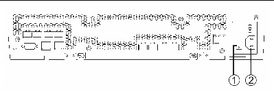

FIGURE 1 6540 Controller Tray AC Power Switch and AC Power Connector

1. At the AC power connector [2], disconnect the two power cords from the controller tray (one from each controller module). See FIGURE 1.

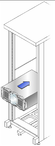

2. Using two people, one at each side of the tray, carefully lift and slide the tray evenly onto the bottom supporting ledge of the left and right rails.
Make sure to slide the tray all the way back into the cabinet. See FIGURE 2.
FIGURE 2 Controller Tray Installation

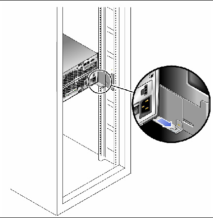

3. Make sure that the rear of the tray fits into the rear clasp. See FIGURE 3.

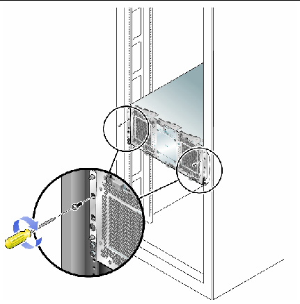

4. Using a #2 Phillips screwdriver and the screws removed earlier, secure the front of the controller tray to the cabinet’s vertical rail. See FIGURE 4.
FIGURE 4 Securing the Front of the Tray

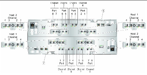

You now have a Sun Storage 6580 or 6780 array with either four or eight host interface ports (using one or two Host Interface Cards (HICs)) and eight drive expansion ports. The following cabling scheme is recommended for your initial setup.
Note - In some cases, the host ports at the end (Host 2, Channel 4) are used or reserved for Remote Replication. |
1. Plug in the host interface cables as described in TABLE 1.
If you now have eight host ports per controller, you can skip some ports to spread the workload across more of the available circuitry.
2. Plug in the drive expansion cables as described in TABLE 1.
FIGURE 5 Host and Expansion Port Locations Controller A and B
