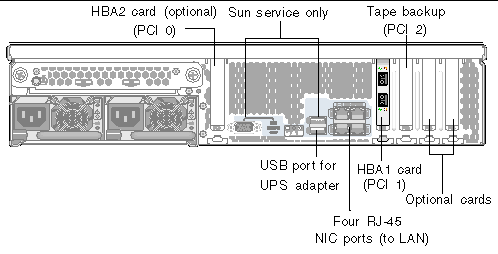

Back Panel Ports and LEDs
The back of the server contains a dual-port Fibre Channel (FC) host bus adapter (HBA) card in PCI slot 1, can optionally contain a second dual-port FC HBA card in PCI slot 0, for high availability. FIGURE D-3 shows the back of the server.
  FIGURE D-3 	   NAS Server Back Panel With Single HBA Card
Each server contains can contain other optional cards, as detailed in the Getting Started Guide for your appliance or gateway system.
The topics below provide detail for:

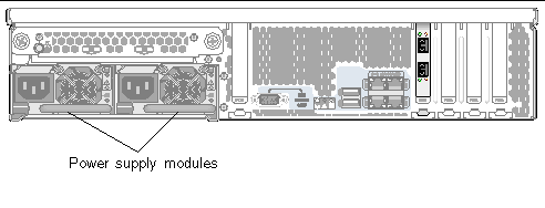

Server Power Supplies
A system's power supply provides power to all of its components. The power supply systems for all units are auto-sensing devices, with automatic adoption to line voltages from 100 to 240 volts, 50 to 60 Hz.
The power supply system in the server comprises two redundant hot-swappable modules in a 1 + 1 configuration, as shown in FIGURE D-5. Each module is capable of maintaining a load of 500 watts. One power supply is required for system operation, with the second power supply providing power redundancy.
  FIGURE D-5 	   Power Supply Modules
Each power supply has the following capabilities:
- 550 watt output
- Internal multi-speed cooling fans
- Built-in load sharing
- Built-in overload protection
- Integral handle for ease when inserting/extracting the device

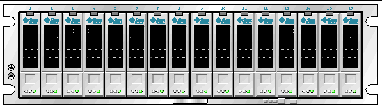

Each controller unit and expansion unit contains either 8 or 16 redundant array of independent disks (RAID) drives of a single drive type (either Fibre Channel (FC), or Serial Advanced Technology Attachment (SATA).
- The FC controller unit contains either 8 or 16 hot-swappable hard drives organized as one or two redundant array of independent disks (RAID)-5 sets, respectively, plus one global hot-spare. The RAID sets are pre-configured: the first 8 drives as one hot spare plus one 6+1 RAID set; the remaining half, if used, as a 7+1 RAID set.
For FC drives, the 6+1 RAID set forms a single volume, and the 7+1 RAID set, if present, forms two volumes of equal size.
- The SATA controller unit also contains either 8 or 16 hot-swappable hard drives, organized into RAID sets as described above for the FC drives. Each SATA RAID set forms two volumes of equal size.

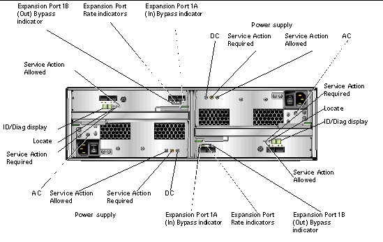

Back of the Controller Unit
The following table describes the LEDs and components on the back of the controller unit. Keep in mind that a particular tray LED icon might not be visible unless the LED is illuminated.
| LED/Indicator
 | Description
| Power Supply LEDs
 DC  | On indicates that the correct DC power is being output from the controller power supply.
 Service Action Required  | Steady amber indicates that the power supply requires service.
 Off indicates that the power supply does not require service.
 Service Action Allowed  | Steady blue indicates that service action can be taken on the power supply without adverse consequences.
 Off indicates that the power supply is engaged and service action must not be implemented.
 AC  | On indicates that AC power is being supplied to the controller power supply.
| Controller LEDs
| ID/Diag display | Seven-segment readouts indicate the ID of the tray.
 Cache Active  | Steady green indicates that data is in the cache.
 Off indicates that all data has been written to disk and the cache is empty.
 Service Action Required  | Steady amber indicates that the controller requires service.
 Off indicates that the controller does not require service.
 Service Action Allowed  | Steady blue indicates that service action can be taken on the controller without adverse consequences.
 Off indicates that the controller is engaged and service action must not be implemented.
| Controller Indicators
 Host Port Rate  | The combined display indicates the host port link rate for the tray:
 LED 1 Off, LED 2 On - 2 Gbits/second
 Expansion Port Rate  | The combined display indicates the expansion port link rate for the tray:
 LED 4 Off, LED 2 On - 2 Gbits/second
 Expansion Port Bypass  | Steady amber indicates that no valid device is detected and that the drive port is bypassed.

LEDs and Indicators
FIGURE D-8 shows the LEDs and indicators on the back of the expansion unit.
  FIGURE D-8 	   Sun StorageTek 5320 Expansion Unit LEDs and Indicators
The following table describes the LEDs and indicators at the back of the expansion unit.
| LED/Indicator
 | Description
| Power Supply LEDs
| Expansion Unit LEDs
 Locate  | Steady white identifies the controller after initiation from the management station.
| Expansion Unit Indicators
 Expansion Port Bypass  | Steady amber indicates that no valid device is detected and that the drive port is bypassed. Off indicates that there is no SFP installed or that the port is enabled.

Disk Drives
Only FC or SATA drives supplied by Sun Microsystems work with the NAS appliances. For the most current support information, contact your Sun sales representative.
Each drive is encased in its own drive shuttle, as illustrated below:
  FIGURE D-9 	Sun StorageTek 5320 Fibre Channel Drive Shuttles
When a drive is determined to be bad, contact Sun Services to replace the failed drive.
Drive shuttles can be replaced individually, without shutting down the expansion unit, controller unit, or NAS server. As necessary, only hot-swap one drive shuttle at a time. Confirm that the RAID subsystem has completed any necessary rebuild before removing another drive shuttle.
Identifying a Drive for Replacement
If a disk drive fails, use the system log or a diagnostic report to identify the drive. The example below shows an entry from the system log:
| Controller 1 enclosure 0  row 0  column 6
This example references the drive in slot 7 of the first enclosure in the first array. Use the guidelines below to interpret log entries and diagnostic reports. Ignore any channel and target numbers that display in the log (not illustrated above). These are maintained for compatibility with legacy systems.
- Controller numbering starts at 0. The controllers in the first array (that is, the first controller unit) are 0 (slot A) and 1 (slot B), and the controllers in the second array are 2 and 3. The arrays are numbered by the NAS OS when you first start up the system after installation, in order as you boot them. If you follow the recommended power-up sequence, the first HBA port on the server (PCI 1) is connected to the first array (controllers 0 and 1), and the second HBA port (PCI 0) is connected to the second array.
- Enclosure numbering starts at 0 and is relative to the array to which it belongs. For example, if the first array has a controller unit and one expansion unit, they are identified as enclosures 0 and 1. Additional expansion units are numbered in the order in which they were booted when you first started up the system after after installing the NAS device. The Getting Started Guide details the recommended power-up sequence.
- The row number is always 0.
- Column numbering starts at 0, and identifies the physical position of the drive as you face the controller unit or expansion unit from the front, moving left (column 0) to right (column 15).
Note: The numbering on the physical device (silk screen) runs from 1 to 16, corresponding to columns 0 through 13.

The Sun StorageTek 5220 NAS Appliance is the basic unit. FIGURE D-1 shows the front of the appliance. You need the software serial number for any calls for service and for adding licenses and you need the hardware serial number if you decide to expand the system.
FIGURE D-22 	Sun StorageTek 5220 NAS Appliance, Front
FIGURE D-3 shows the back of the appliance. The appliance contains a dual-port fibre channel (F C) host bus adapter (HBA) card in PCI slot 1. The other slot, PCI slot 0, can be empty or contain one of the optional cards.
FIGURE 4-23 	Sun StorageTek 5220 NAS Appliance With Single HBA Card, Back
One of the ports on the HBA card in PCI slot 1, HBA Port 2, can be used for connecting to tape backup. Its other port, HBA Port 1, is dedicated to connecting to the controller unit.
PCI slot 0 can contain the following options:
- A dual-port copper 10/100/1000 Gigabit Ethernet card
- A dual-port optical Gigabit Ethernet card
- A FC HBA card for tape backup
- A SCSI HBA card for tape backup
An uninterrupted power supply device (UPS), using the USB-to-Serial Port Adapter/Convert Cable included in the ship kit. If a power outage occurs, the UPS maintains the operation of the system. If the battery in the UPS loses power, the UPS performs a graceful shutdown of the system. Connecting the UPS adapter cable to a supported local UPS device enables the appliance to monitor the state of the UPS.
