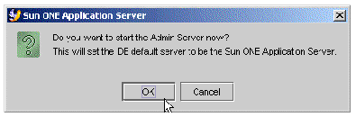

If you have not already started the admin server from outside the IDE, a query window may pop up, asking whether you want to start the admin server. This refers to the admin server for the default domain.
Sun ONE Application Server dialog box for starting the Admin Server. Buttons are OK and Cancel.
3. Click OK.

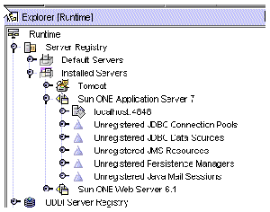

4. Expand the Server Registry node and expand the Installed Servers node.
5. Expand the Sun ONE Application Server 7 node.

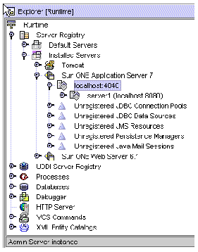

Runtime tab of Explorer showing localhost:4848 (new admin server instance) under Sun ONE Application Server 7 node.
The node localhost:4848 is your Admin Server instance.
6. Expand the localhost:4848 node to see the application server instance server1.
Runtime tab of Explorer showing expanded localhost:4848 (default admin server instance) under Sun ONE Application Server 7 node. Server1(localhost:8080) is the application server instance.

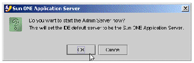

A query window may display asking "Do you want to start the Admin Server now?" This refers to the default domain, domain1, which can only be run by a superuser or administrator.
If you click OK, this action creates and starts an admin server that you can not use.
4. Click Cancel.
