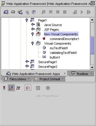

Note that the technical name for these components is ConfigurableBeans. That is the name by which these entities are declared within the component library manifest. However, within the IDE toolset, application developers see the more developer friendly term Non-Visual Components.
This figure shows the Non-Visual Components Explorer node.
Only component authors need to understand that ConfigurableBeans and Non-Visual Components are essentially the same thing.
Technically speaking, the Non-Visual Components, which are visible as a sub-node of a ContainerView, are just a special case of the IDE toolset exposing ConfigurableBeans as nodes.

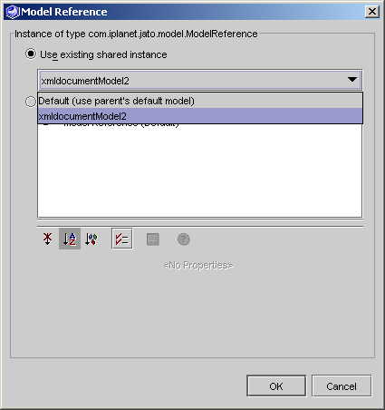

The IDE toolset uses a lookup algorithm to determine if the configuration property type corresponds to a registered ConfigurableBean type, and if so, it automatically invokes one of two special ConfigurableBean editors. These special Web Application Framework ConfigurableBean editors are shown below.

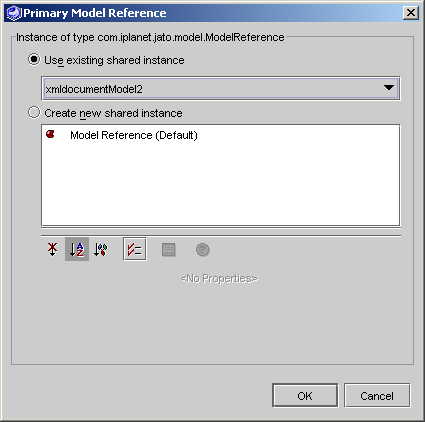

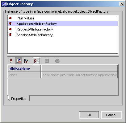

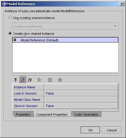

This figure shows the Dedicated ConfigurableBean editor (example property, Object Factory). This figure shows the Shared ConfigurableBean editor (example property, Model Reference). This figure shows the Shared ConfigurableBean editor displaying the "existing" shared-instance drop-down list. This figure shows the Shared ConfigurableBean editor with the "create new" shared instance selected.

The IDE toolset will invoke one of the two editors above based on a further subtlety in the ConfigPropertyDescriptor, known as the value policy. The details of value policy are beyond the scope of this section, for more information see ConfigPropDescriptors API - Value Policy.
For this section, it is sufficient to observe that while their layout is radically different, both of the ConfigurableBean editors provide a common core functionality. Both of these editors provide the application developer with a dynamic list of ConfigurableBean types which are assignable from the configuration property type. That is the key value add of the ConfigurableBean component. It is this mechanism which allows the IDE to seamlessly and dynamically incorporate new choices into properties that otherwise would normally be severely restricted.

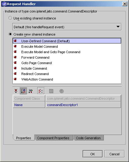

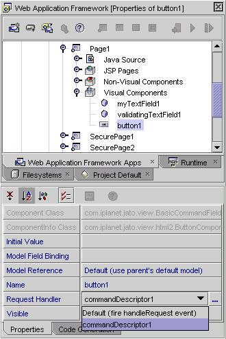

This figure shows the CommandField with CommandDescriptor property selected. This figure shows the CommandDescriptor editor with the Properties tab selected.
