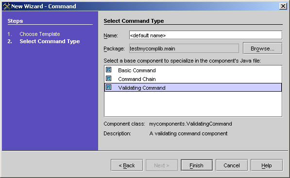

2. Create a new Command object.
Note - If you have not done this before, complete the Sun Java Studio's Web Application Framework Tutorial). |
The "New Command" wizard should now look as follows:
3. Select "Validating Command" from the component list, and complete the wizard.

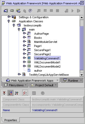

4. Take the default settings and let the wizard create ValidatingCommand1 for you.
After the wizard completes, you can see that the IDE toolset has created a new class based on the component supplied template.
You application should now contain a ValidatingCommand1 object.

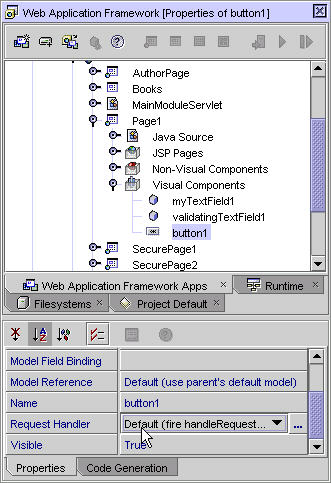

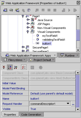

a. Select its Visual Components sub-node.
b. Select the node for button1 (below).

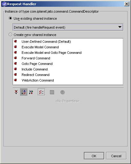

6. Edit button1's Request Handler property.

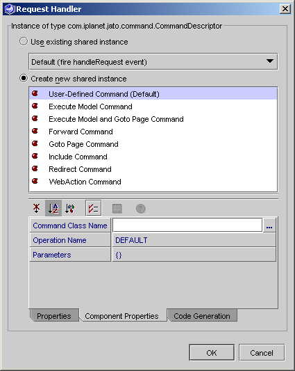

a. Click the property's ellipsis to bring up the full blown Command Descriptor Property Editor.
This is a very sophisticated editor and takes some effort to get familiar with it, but the payoff is substantial, as it offers exciting additional opportunities to component authors, which is discussed later.
First you must become comfortable using the editor. The Command Descriptor Property Editor contains a dynamic list of available CommandDescriptor types and it also contains an embedded property sheet (at the bottom of the editor) which will dynamically display the properties for the type of CommandDescriptor that is selected (this will become more clear in subsequent steps).
7. Select the Create new shared instance radio button.
Note - The meaning of "shared instance" is explained a few steps later. |
8. Select the "User-Defined Command (Default)" item from the list of available descriptor types (see graphic above).
As you select a given command descriptor type, the bottom section of the editor displays the properties which are particular to the type of descriptor you selected.
Your property editor should look as follows:

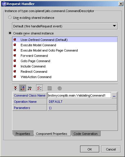

The embedded property sheet contains three tabs, as follows:
9. Select the Component Properties tab.

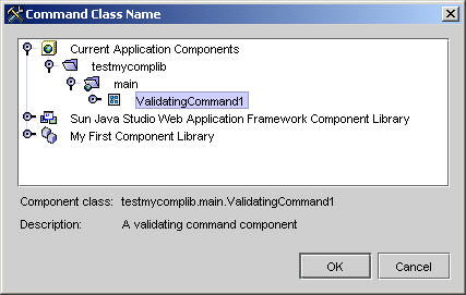

10. Within the Component Properties tab, select the Command Class Name property (shown below).
The Command Class Name property is of type java.lang.String.
11. Instead of directly typing into the exposed property field, select the ellipsis to bring up the full blown editor.
You should now see that the Command Class Name property editor is actually the same non-extensible Component browser that you have seen in several other contexts.
In this context, however, it intentionally filters the list of components to those which are appropriate for the context (for example, Command components).

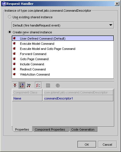

12. Fully expand the Current Application Components node, and you should see "ValidatingCommand1" available (shown below).
13. Select the "ValidatingCommand1" node from the property editor, and click OK (shown above).
Notice that the Command Class Name property in the CommandDescriptor's embedded property sheet now contains the fully qualified class name for ValidatingCommand1 (shown below).
14. Click OK to complete the configuration of the CommandDescriptor.

Note that the value of button1's Request Handler property now reads "commandDescriptor1" (shown below).
You might be wondering where commandDescriptor1 is.
You might also be wondering about the "Create new shared instance" radio button in the CommandDescriptor property editor that you selected (shown above).
The following step provides the answers.

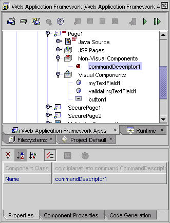

15. Expand the Page1's Non-Visual Components node (shown below).
There you will find a new non-visual component node "commandDescriptor1". It is the CommandDescriptor object you configured just moments ago. It is a CommandDescriptor that you configured as a "shared instance".
To visually express its "shared" nature, the IDE toolset provides the "Non-visual Components" node to house all of these shared instances.
The "Non-Visual Components" node is an Web Application Framework component model construct. It provides a ContainerView scoped space for the configuration of JavaBean objects (for example, Configured Beans) which are referenceable by properties elsewhere in the current ContainerView.
In this example, "commandDescriptor1" is a configured CommandDescriptor (which is a JavaBean), which is referenced by button1's Request Handler property. The key to this component model feature is that the same configured non-visual component can be referenced by more than one property within the current ContainerView scope (for example, more than one button or HREF could have its CommandDescriptor property also set to refer to commandDescriptor1).
A quick glance at the IDE toolset generated Java code for Page1 would reveal how this is expressed in Java terms. The benefits to both component authors and application developers are substantial. As a further clarification, not only can multiple CommandFields (for example, Buttons, HREFs, and so on) share commandDescriptor1 by each referring to it in their specific "Command Descriptor" property, but any property within the current ContainerView whose type is assignable from com.iplanet.jato.command.CommandDescriptor may be set to refer to commandDescriptor1. In essence, the non-visual components are class scoped, IDE configurable JavaBean objects which might be referenced in a type safe manner by any number of other visual components within the class.
At this time, the IDE toolset does not support the ability to have one non-visual component refer to another non-visual component.
Application developers must understand and respect the shared nature of the non-visual components. Modifications to the configuration of an existing non-visual component will indirectly affect all circumstances in which that instance of the non-visual component is referenced at run-time.This is why the CommandDescriptor editor (or more generally, the non-visual component editor) always allows one to "Create a new shared instance" of a non-visual component. More often than not, multiple CommandFields within a given ContainerView will not share the same instance of CommandDescriptor, but rather, refer to different and distinctively configured instances of CommandDescriptor.

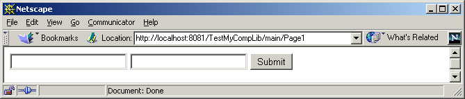

Now you have configured Page1 to instantiate ValidatingCommand1 and invoke its execute method whenever button1 is indicated in a form submit.

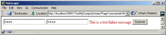

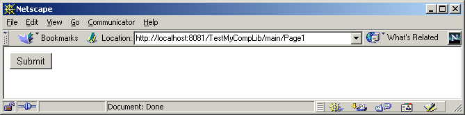

16. Test run the page flow from Page1 to SecurePage1 which is now controlled by ValidatingCommand1.
The contents of Page1.jsp should show up in the browser.
17. Enter an invalid value (any non-integer) in the ValidatingTextField text input, and submit the page.
The page should immediately redisplay with the text of the "Validation Error Message" property immediately following the ValidatingTextField.
18. Enter a valid value (for example, 55, or any other valid Integer), and submit the page.
Now, instead of Page1 redisplaying as it did earlier in this guide, the logic within ValidatingCommand1 will display SecurePage1.
