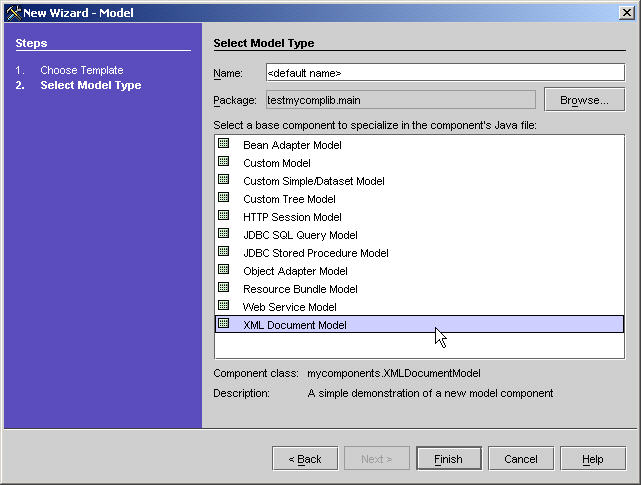

The answer is yes. In fact, whenever application developers create a new Model via the Model wizard, they are in fact extending an extensible Model component and creating an application-specific Model. This new application specific Model is by definition a non-extensible component. Whenever an application developer attempts to fill out a property of type ModelReference, the IDE toolset will invoke a component browser that allows the application developer to choose from a set of existing non-extensible Models. For instance when a application developers specify a DisplayField's Model Reference property, the IDE toolset presents them with a browser that allows them to select a Model.
Is it possible to create one of these non-extensible Models and add it to a library so that it can be distributed? Again, the answer is yes. See the section Developing and Distributing Non-Extensible Model, Command and ContainerView Components (next).
Developing a Non-Extensible Model Component
A non-extensible Model component is a concrete Model that has been created within the IDE from an extensible Model component. It is no different from an application specific Model, except that is distributed in a JAR file and can be incorporated into multiple applications. The distribution technique is common for non-extensible Models, ContainerViews, and Commands. See the section Developing and Distributing Non-Extensible Model, Command and ContainerView Components

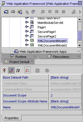

Test the New Component
1. Deploy the new version of the library into your previously created test application.
Important IDE note: The IDE will not let you delete or copy over a JAR file that is currently mounted unless this is done via the IDE using ANT tasks which share the same VM as the IDE and share the file locks. You should shutting down the IDE whenever you need to replace one of the JAR files that is currently mounted. If you are trying to test the new version of component library in a project that is already opened inside the IDE, first shut down the IDE. Once the IDE has released its hold on the old copy of the library JAR file, you can copy the new version of the JAR file over the old version. After successfully deploying the new version of the library, you can re-open the application in IDE.

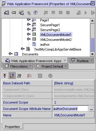

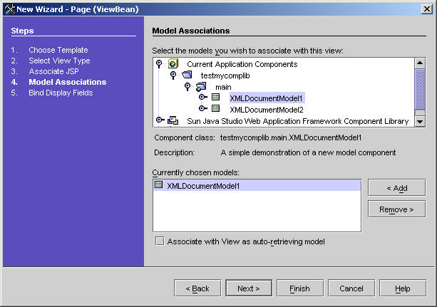

2. Create a new Model object.
If you have not done this before, complete the Sun Java Studio's Web Application Framework Tutorial.
The new Model wizard should now look as follows:
Note - Depending upon the version of Web Application Framework, you might not see all of the models that are shown next. The important point is that you see the entry for "XML Document Model".
This figure shows the Select Model Type panel of the New Model wizard.
3. Select the "XML Document Model" from the component list and complete the wizard.
Take the default settings and let the wizard create "XMLDocumentModel1" for you.
After the wizard completes, you can see that the IDE toolset has created a new class based on the component supplied template.

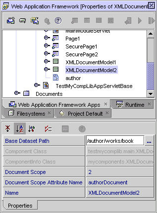

4. To test your mode fully, create a second XML Document Model.
Your application should now contain two XML Document Models (XMLDocumentModel1 and XMLDocumentModel2).
Note the Base Dataset Name, Document Scope, and Document Scope Attribute Name properties.
This figure shows the two XML Document Models that were just created: XMLDocumentModel1 and XMLDocumentModel2.
Note above that the Document Scope property value is the raw integer 2. This is because XMLDocumentModelComponentInfo declared the DocumentScope property thus. The type is Integer.Type, and the default value is javax.servlet.jsp.PageContext.REQUEST_SCOPE. The net effect in the IDE will use the default Integer property editor which will express the raw integer value, in this case 2.
descriptor=new ConfigPropertyDescriptor(
"documentScope",Integer.TYPE);
descriptor.setDisplayName("Document Scope");
descriptor.setHidden(false);
descriptor.setExpert(false);
descriptor.setDefaultValue(new Integer(
javax.servlet.jsp.PageContext.REQUEST_SCOPE));
descriptors.add(descriptor);
You would be correct in thinking that this is a poor user interface since most developers will not know that 2 corresponds to request scope. Therefore, as a follow up exercise, you will see later how to substitute a more user friendly property editor in place of the default Integer property editor.

a. Select the XMLDocumentModel1 node.
b. Edit its Document Scope Attribute Name property.
Set the value to "authorDocument".
c. Leave the Document Scope and the Base Dataset Path properties unchanged.
This figure shows the XMLDocumentModel1 node and its property sheet with the Document Scope Attribute Name field set to authorDocument.

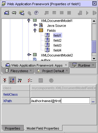

h. Select the field1 node.
Select the Model Field Properties tab on its property sheet.
i. Edit field1's XPath property.
Set the value to the XPath expression "/author/name/@first".
This figure shows the XMLDocumentModel1 Explorer node, with the Fields node expanded and the property sheet of the Field1 node.

6. Configure XMLDocumentModel2 to access the "books" dataset.
a. Select the XMLDocumentModel2 node.
c. Edit its Base Dataset Path property.
Set the value to the XPath expression "/author/works/book".
That is an XPath expression that will address the collection of book entries (for example, a Web Application Framework dataset).
d. Leave the Document Scope property unchanged.
This figure shows the XMLDocumentModel2 node and its property sheet.

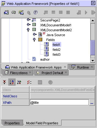

g. Right-click, and select the pop up menu's Add Field ... action to add "field1", "field2", and "field3".
h. Edit each field's XPath property to XPath expressions relative to the value of the Base Dataset Path property set above.
This figure shows the XMLDocumentModel2 field nodes and the Model Field Properties tab of field1.

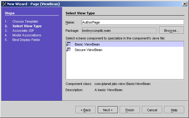

7. Create the AuthorPage
a. Invoke the "New View" wizard.
This figure shows the Select View Type panel of the New ViewBean wizard.
b. Take the default values in the Associate JSP panel, and press Next.
c. In the Model Associations panel (shown in the next figure), expand the Current Application Components node until you find "XMLDocumentModel1".
That will cause the "XMLDocumentModel1' to appear in the Currently chosen models section of the panel.
This figure shows the Model Associations panel of the New ViewBean wizard.

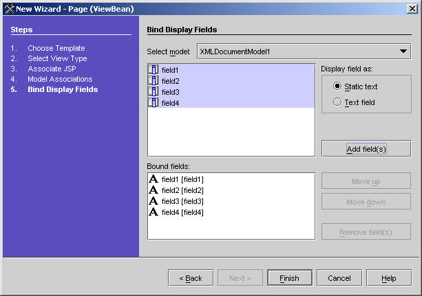

d. In the Bind Display Fields panel (shown in the next figure), select all four of the Model fields that are available, and press the Add Fields button.
That will cause four entries to appear in the Bound Fields section of the panel.
e. Press Finish.
This figure shows the Bind Display Fields panel of the New ViewBean wizard.

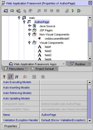

After completing the wizard in the manner described above, you should find that the AuthorPage node looks like this.
The individual child display fields should be properly bound to the corresponding XMLDocumentModel1 fields.
This figure shows the AuthorPage Explorer node and its property sheet.

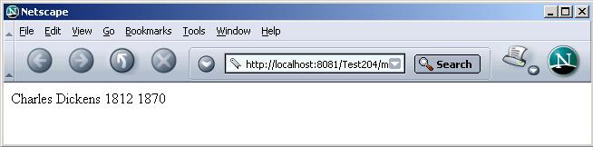

9. Compile all the classes in the application and test run the AuthorPage.
The author's data should appear in the browser as follows:
This figure shows the author's data in the browser.

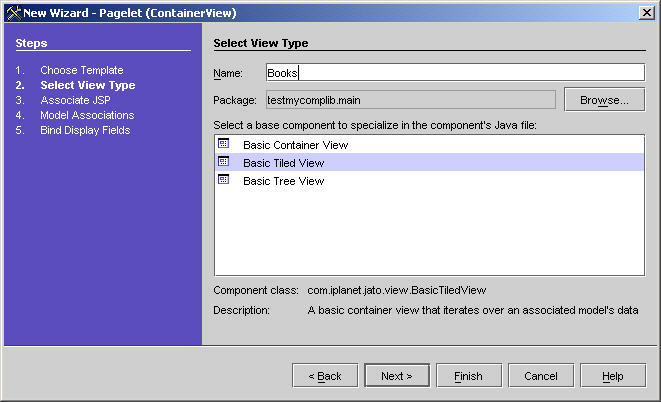

b. In the Select View Type panel (shown in the next figure) select the "Basic Tiled View" component.
c. Explicitly set the Name to be "Books".
d. Press Next.
This figure shows the Select View Type panel of the New ContainerView wizard.

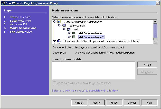

That will cause the "XMLDocumentModel2' to appear in the Currently chosen models section of the panel.
This figure shows the Model Associations panel of the New ContainerView wizard.

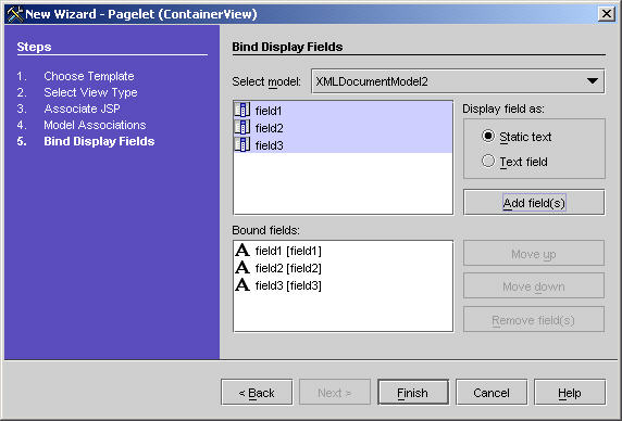

That will cause three entries to appear in the Bound Fields section of the panel.
This figure shows the Bind Display Fields panel of the New ContainerView wizard.

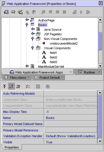

This figure shows the Books TiledView Explorer node and its property sheet.

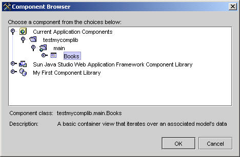

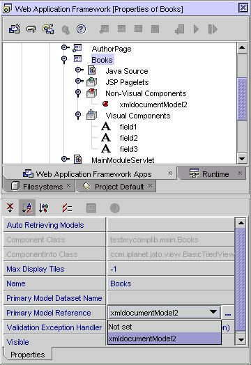

11. The TiledView requires one additional configuration step that you have not seen before in this guide.
You need to configure the :Book TiledView's Primary Model Reference property to reference "XMLDocumentModel2". If you do not configure this property, the test run of this TiledView will show no data. That is a common Web Application Framework application developer error.
Edit the Primary Model Reference property (shown next), and from its drop down list select the "xmldocumentModel2" value.
This figure shows the Primary Model Reference property in the property sheet for the Books Explorer node.

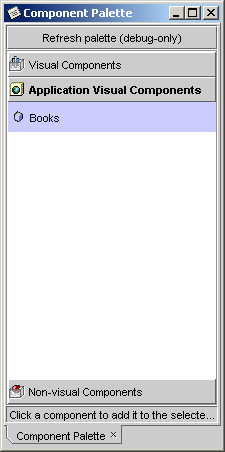

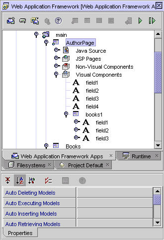

12. Before you can test run the Books TiledView, you must add it to a ViewBean. To make this example more interesting, add the Books TiledView as a child of the AuthorPage. This is a good example of Web Application Framework's hierarchical view support.
Add an instance of Books TiledView to AuthorPage. Again, you can achieve this by selecting Books TiledView from either the Component Palette or the Component Browser, just as you did earlier with the various text fields and button components. Except this time, the component will be located in the Current Application Components section of either the Component Palette or Component Browser.
This figure shows the Component Palette with the contents of the Application Visual Components tab. This figure shows the Books node in the Component Browser.
After adding Books as a child view, the AuthorPage node should look as follows:

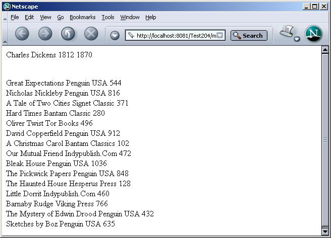

14. Test run AuthorPage again.
Make sure you select the ExecutePage (Redeploy) action, not the Execute Page action. Otherwise you will not see the effects of the recent changes.
The contents of AuthorPage.jsp should show up in the browser (because the user had accumulated the required tokens).
This figure shows the contents of the AuthorPage.jsp in a browser.
