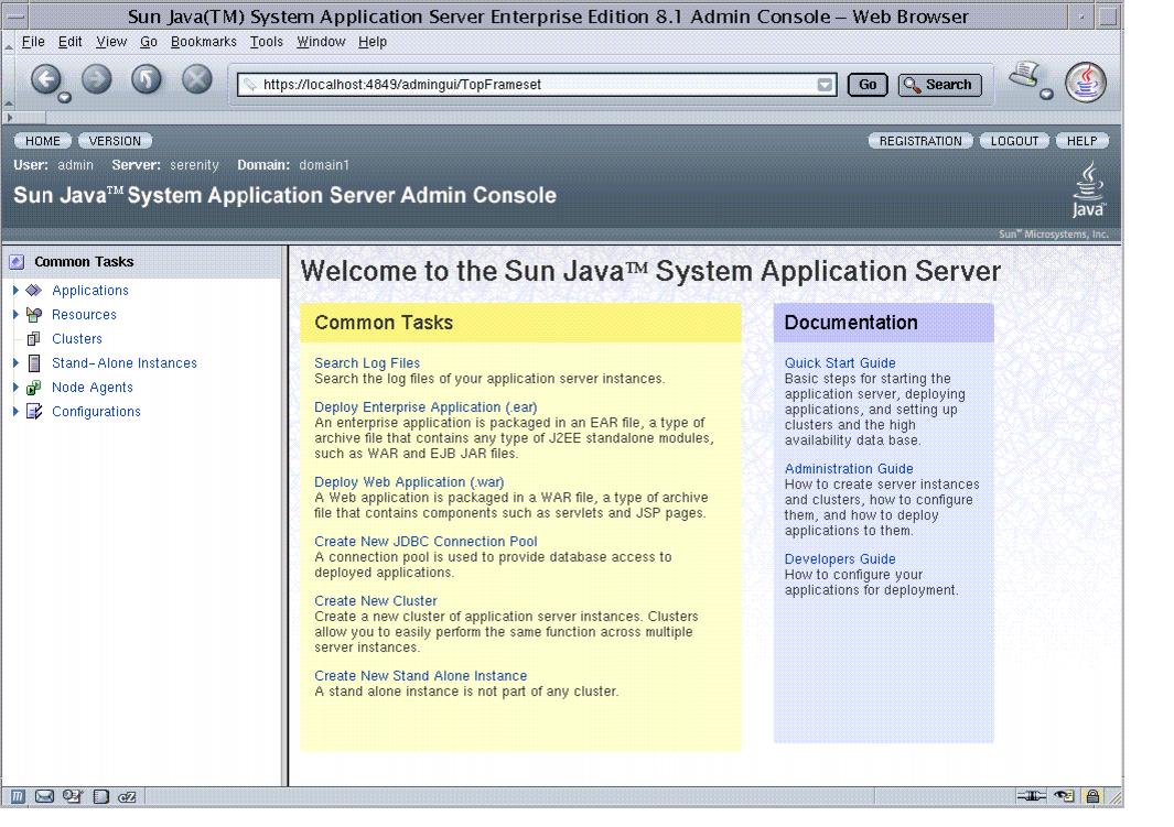

When the Admin Console appears, it looks like this:
In the left pane, you can select what you want to manage from the tree provided. In the right pane, various administrative tasks are listed under the “Common Tasks” heading.

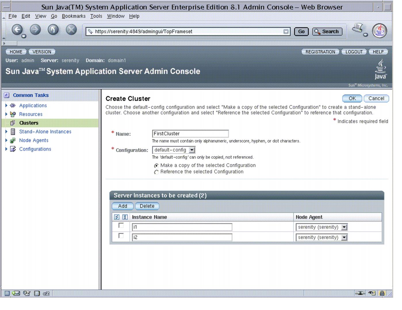

- On the right pane, under Common Tasks, click Create New Cluster to display the Create Cluster input page.
- Type FirstCluster as the Name of the new cluster.
- From the drop-down list of available configuration templates, select the default-config configuration and choose Make a copy of the selected Configuration.
- Click the Add button twice, to create two entries to specify two instances for the cluster.
- Type i1 and i2 as instance names. The node agent name is automatically populated with the name of the local machine.
You see a screen like this:
- Click OK. The create process can take a few minutes.

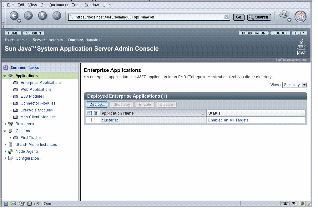

- Click OK.
The clusterjsp application is now deployed to FirstCluster.
This screen confirms that the clusterjsp application is now deployed to FirstCluster.
