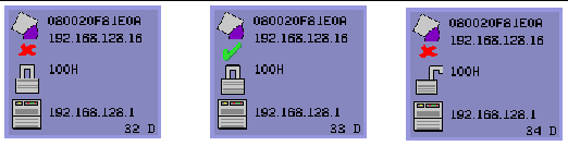

The following icons are displayed when there might be a security breach.
Definition: The client is refusing to connect to a server because it is unable to verify the validity of the Sun Ray server.
This error can occur only if an unknown Sun Ray server intercepts the messages and tries to emulate a valid Sun Ray server. This is a session security breach.
Definition: The server is refusing to grant a session to the client because the client is unable to fulfill the server's security requirements.
1. Check the client's firmware version.
This error may occur with firmware versions earlier than 2.0 if the server is configured for hard security mode.
As an alternative, confirm whether your site requires hard security mode. If not, the session can be enabled with soft security mode.
When a site policy disallows pseudo sessions, DTUs configured as token readers display the Card Reader icon instead of the Login Dialog box card.
Definition: The Card Read Error OSD icon appears whenever the firmware is unable to read the card due to one of the following causes:
Definition: If the current authentication policy allows access only by card, this OSD icon appears and prompts the user to insert a card.
Definition: The Access Denied OSD icon appears when the current authentication policy denies access to the presented token. Specifically, this icon is displayed if a disabled card has been inserted into an DTU.

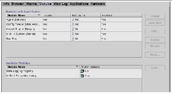

Usually, if all the software is installed, the agent for Sun Ray monitoring starts automatically.
If the Sun Ray server has the Sun Management Center agent component installed, but the Detail window shows no Sun Ray object for the Sun Ray server node, load the Sun Ray module:
Note where the Sun Ray module is listed (if it is not listed, see No Sun Ray Module). For the module to be loaded, it should be listed in Modules with Load Status. In addition, it should be loaded and enabled.
2. If the Sun Ray module is listed, highlight it and then click the Load button.
This loads the module and moves it to the Modules with Load Status list.
3. If the Sun Ray module is disabled, highlight it and then click the Enable button.
4. Return to the Detail window.
The Detail window shows a Sun Ray object for the Sun Ray server node.
If, after clicking the Modules tab on the Details window of the Sun Ray server node, the Sun Ray module is not listed, activate the Sun Ray module:
1. Register the module by typing:
This command adds the module to the Sun Management Center and restarts the agent if it is active.
2. If you receive the following message, perform steps 3 and 4.
Starting the SunMC agent... NOTICE: SunMC agent failed to start. To start it manually run the command |
3. Check to see if the agent is running:
If the Sun Management Center agent is running, wait then check the Detail window.
4. If the agent is not running, type the following to start it:
