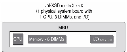

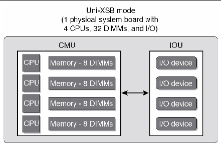

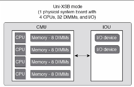

The following figures show a PSB in Uni-XSB mode on entry-level, midrange, and high-end servers.
FIGURE 4-1 A Physical System Board in Uni-XSB Mode on an Entry-Level Server
FIGURE 4-2 A Physical System Board in Uni-XSB Mode on a Midrange Server
FIGURE 4-3 A Physical System Board in Uni-XSB Mode on a High-End Server

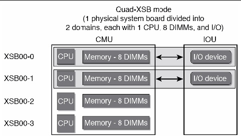

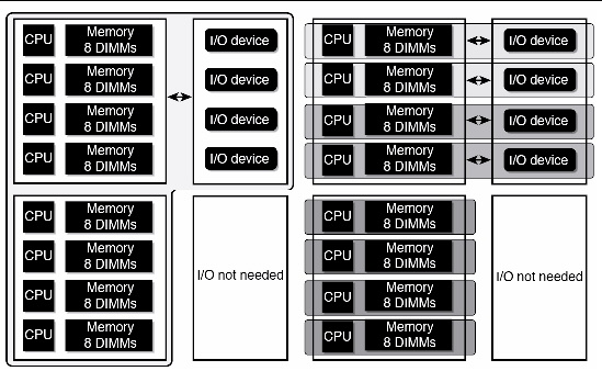

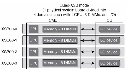

FIGURE 4-4 shows a PSB in Quad-XSB mode on a midrange server, and FIGURE 4-5 shows a PSB in Quad-XSB mode on a high-end server.
The logical dividing between Uni-XSB and Quad-XSB is done using the setupfru command.
FIGURE 4-4 A Physical System Board in Quad-XSB Mode on a Midrange Server
FIGURE 4-5 A Physical System Board in Quad-XSB Mode on a High-End Server

In FIGURE 4-4, one domain (for example, domain 0) must contain XSB 00-0, and the second domain (for example, domain 1) must contain XSB 00-1, because of the I/O requirement for a domain. The remaining XSB 00-2 and XSB 00-3 can be assigned to either domain, or to none.

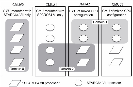

Midrange and high-end servers support system boards that contain SPARC64 VII+, SPARC64 VII, and SPARC64 VI processors, or a mix of these processor types. Entry-level servers support only SPARC64 VII+ and SPARC64 VII processors.
FIGURE 4-7 shows an example of a mixed configuration of SPARC64 VII and SPARC64 VI processors.
FIGURE 4-7 CPUs on CPU/Memory Board Unit (CMU) and Domain Configuration
Different types of processors can be mounted on a single CMU, as shown in CMU#2 and CMU#3 in FIGURE 4-7. And a single domain can be configured with different types of processors, as shown in Domain 2 in FIGURE 4-7.
