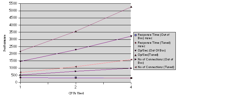

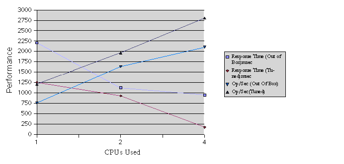

Static Content Test
This test was performed with static download of a randomly selected file from a pool of 400 directories, each containing 100 files ranging in size from 5 KB to 250 KB. Tests were done with the file cache configured to include all files in the directories. The goal of static content tests was to identify the maximum number of conforming connections the server could handle. A conforming connection is one that operates faster than 320 Kbps (kilobits per second).
Simultaneous connections: 1500
Figure 7-1 Static Content Test

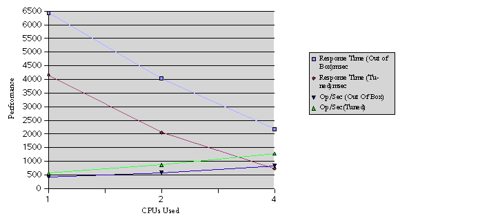

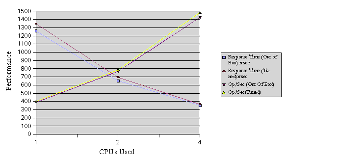

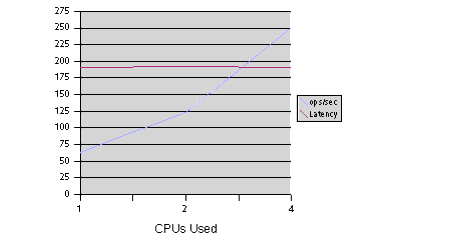

Dynamic Content Test: C CGI
This test was performed by accessing a C executable called printenv.This executable outputs approximately 0.5 KB of data per request. The goal was to saturate the CPUs on the server.
Number of clients: 2400
Figure 7-3 Dynamic Content Test: C CGI

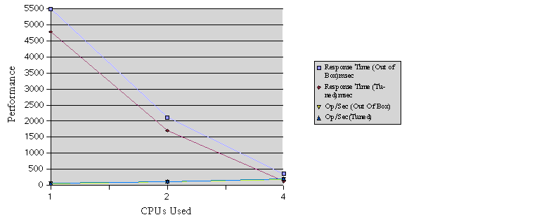

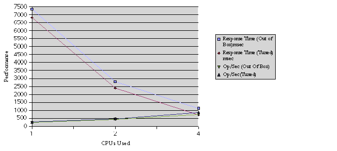

Dynamic Content Test: Perl CGI
This test ran against a Perl script called printenv.pl that prints the CGI environment. This script outputs approximately 0.5 KB of data per request. The goal was to saturate the CPUs on the server.
Number of clients: 450
Figure 7-4 Dynamic Content Test: Perl CGI

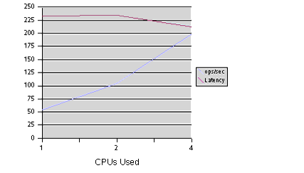

Dynamic Content Test: NSAPI
The NSAPI module used in this test was printenv2.so. It prints the NSAPI environment variables along with some text to make the entire response 2 KB. The goal was to saturate the CPUs on the server.
Number of clients: 6300
Figure 7-5 Dynamic Content Test: NSAPI

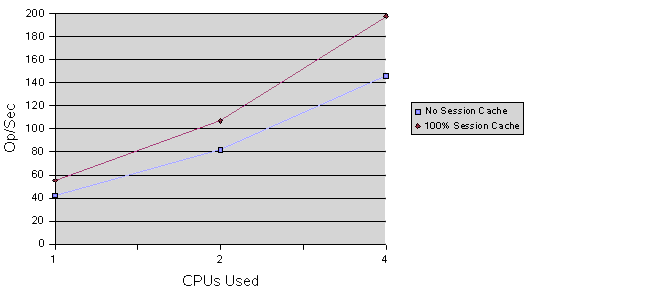

SSL Performance Test: Perl CGI
This test was performed by accessing the printenv C executable in SSL mode. The goal was to saturate the CPUs on the server. The test was performed in SSL mode with the SSL session cache both enabled and disabled.
Figure 7-7 SSL Test: Perl CGI

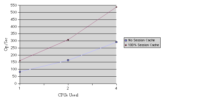

SSL Performance Test: C CGI
Figure 7-8 SSL Test: C CGI
Table 7-12 SSL/C CGI: No Session Cache Reuse
CPUs
Op/Sec (Out of Box)
Op/Sec (Tuned)
1
84.8
82.73
2
165.0
164.38
4
290.6
291.63
Table 7-13 SSL/C CGI: 100% Session Cache Reuse
CPUs
Op/Sec (Out of Box)
Op/Sec (Tuned)
1
160.65
165.69
2
308.11
310.51
4
538.54
550.19
Table 7-14 SSL/C CGI: Session Cache Comparison
CPUs
No Session Cache
(Tuned)100% Session Cache
(Tuned)1
82.73
160.65
2
164.38
308.11
4
291.63
538.54

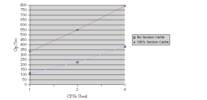

SSL Performance Test: NSAPI
Figure 7-9 SSL Test: NSAPI

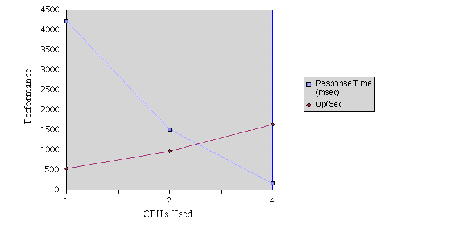

JDBC Connection Pooling with OCI Driver
This test tested the scalability and performance of the JDBC connection pooling module. In this test a simple servlet requests a row from a large database and prints its content. An Oracle database and the Oracle OCI driver were used for the test. JDBC connection pool resource configuration is shown below (server.xml).
Number of clients: 3600
Figure 7-10 JDBC Connection Pooling Test
Table 7-18 JDBC Connection Pooling Test
CPUs
Response Time (msec)
Op/Sec
1
4223.66
529.14
2
1508.53
966.74
4
153.19
1634.94
