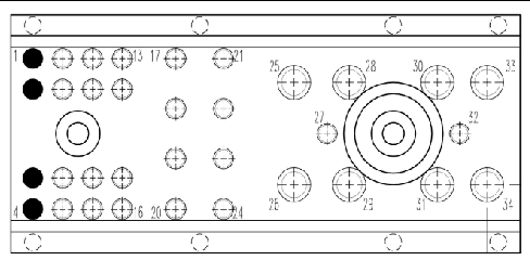

TABLE B-2 ATCA Zone 1 Connector (J9) Pins
Pin #
Pin Name
Pin #
Pin Name
1
NC
18
NC
2
NC
19
NC
3
NC
20
NC
4
NC
21
NC
5
HA(0)
22
NC
6
HA(1)
23
NC
7
HA(2)
24
NC
8
HA(3)
25
SHELF_GND
9
HA(4)
26
GND
10
HA(5)
27
NC
11
HA(6)
28
VRTN_A
12
HA(7)
29
VRTN_B
13
SCL_A
30
EARLY_A
14
SCD_A
31
EARLY_B
15
SCL_B
32
NC
16
SCD_B
33
-48V_A
17
NC
34
-48V_B
FIGURE B-2 ATCA Zone 1 Connector (J9)
