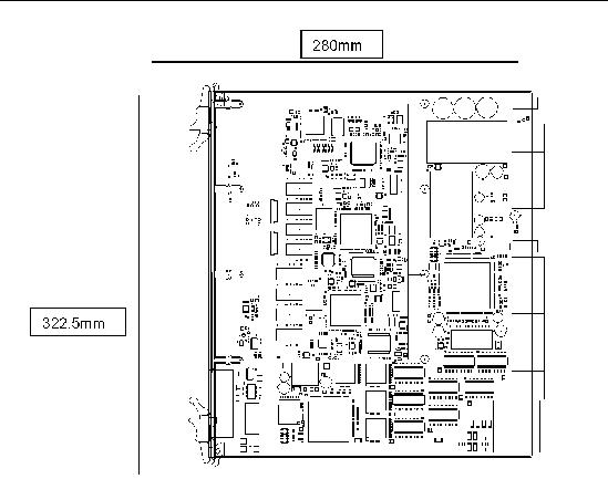

This section includes the mechanical specifications for dimensions and weight.
The switch meets the PICMG 3.0 AdvancedTCA Specification R2.0 ECN002 and AMC.0 R2.0 for all mechanical parameters.
Mechanical dimensions are shown in the illustration and are outlined in the following table.
