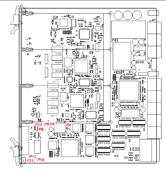

3.2 Jumper Locations
FIGURE 3-1 shows the locations of the jumper settings.
FIGURE 3-1 Switch Jumper Locations
