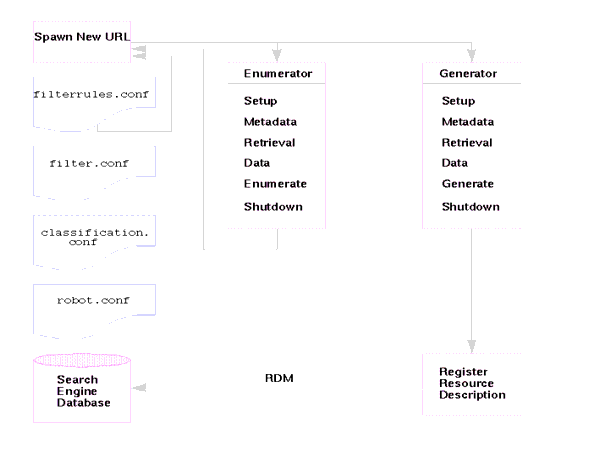

Figure 9-1 illustrates how the Search Engine robot works. In Figure 9-1, the robot examines URLs and their associated network resources. Each resource is tested by both the enumerator and the generator. If the resource passes the enumeration test, the robot checks it for additional URLs. If the resource passes the generator test, the robot generates a resource description that is stored in the Search Engine database.
Figure 9-1    How the Robot Works
This figure illustrates how the robot works. See the text following the figure for a description of the process.

The Filtering Process
The robot uses filters to determine which resources to process and how to process them. When the robot discovers references to resources as well as the resources themselves, it applies filters to each resource in order to enumerate it and to determine whether or not to generate a resource description to store in the Search Engine database.
The robot examines one or more seed URLs, applies the filters, and then applies the filters to the URLs spawned by enumerating the seed URLs, and so on. The seed URLs are defined in the filterrules.conf file.
A filter performs any required initialization operations and applies comparison tests to the current resource. The goal of each test is to either allow or deny the resource. A filter also has a shutdown phase during which it performs any required cleanup operations.
If a resource is allowed, that means that it is allowed to continue passage through the filter. If a resource is denied, then the resource is rejected. No further action is taken by the filter for resources that are denied. If a resource is not denied, the robot will eventually enumerate it, attempting to discover further resources. The generator might also create a resource description for it.
These operations are not necessarily linked. Some resources result in enumeration; others result in RD generation. Many resources result in both enumeration and RD generation. For example, if the resource is an FTP directory, the resource typically will not have an RD generated for it. However, the robot might enumerate the individual files in the FTP directory. An HTML document that contains links to other documents can receive an RD and can lead to enumeration of the linked documents as well.
The following sections detail the filter process:
Stages in the Filter Process
Both enumerator and generator filters have five phases in the filtering process. They both have four common phases, Setup—Performs initialization operations. Occurs only once in the life of the robot., Metadata—Filters the resource based on metadata that is available about the resource. Metadata filtering occurs once per resource before the resource is retrieved over the network. Table 9-2 lists examples of common metadata types. The table contains three columns. The first column lists the metadata type, the second column provides a description, and the third column provides an example., Data—Filters the resource based on its data. Data filtering is done once per resource after it is retrieved over the network. Data that can be used for filtering include:, and Shutdown—Performs any needed termination operations. Occurs once in the life of the robot.. If the resource makes it past the Data phase, it is either in the Enumerate—Enumerates the current resource in order to determine if it points to other resources to be examined. or Generate—Generates a resource description (RD) for the resource and saves it in the Search Engine database. phase, depending on whether the filter is an enumerator or a generator. The phases are as follows:
  • Setup—Performs initialization operations. Occurs only once in the life of the robot.
