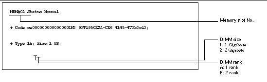

Explanation of DIMM Information
B.1 Confirmation of DIMM Information FIGURE B-1 Explanation of DIMM Information.
FIGURE B-1 shows the example of DIMM information.
FIGURE B-1 Example of DIMM Information
