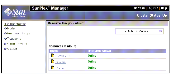

Once the setup scripts have been run, you can either manage the HA-NFS service from the command line or through the SunPlex Manager GUI. By default, each cluster node is configured with an Apache web server that listens on port 3000. Since a password is required to run SunPlex Manager, a secure port is used.
1. Enter the name of one of the cluster nodes in a web browser.
https://node1.siroe.com:3000 |
After entering a login (root) and password, the cluster configuration data is displayed.
2. To examine the HA-NFS resource group that was set up, click on Resource Groups in the left window pane.
The Action Menu allows you to perform common cluster administration functions like switching the service to the other cluster node. A nice feature of SunPlex Manager is that the command that is executed for the chosen action is displayed. You can use this output as a guide to developing scripts for common administration functions.
