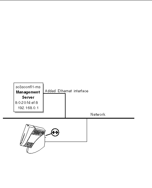

FIGURE F-1 shows the management server with an additional Ethernet interface used for the interconnect.
