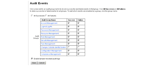

</Object>There are eight default event groups:
You can configure each group from the Audit Events page of the Identity Manager administrative interface (configure/auditeventconfig.jsp). The page allows you to configure successful or failed events for each group. The interface does not support adding or modifying enabledEvents for groups, but you can do this by using the Identity Manager debug pages.
The following sections list the default event groups and the events they enable.

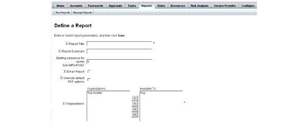

- Create a tampering report by selecting Reports > New > Audit Log Tampering Report.
- When the Define a Tampering Report page displays (as shown in the following figure), enter a title for the report and then Save it.
Figure 1. Configuring an Audit Log Tampering Report
Note You can also specify the following optional parameters:
- Report Summary – Enter a descriptive summary of the report.
- Starting sequence for server '<server_name>' – Enter the starting sequence number for the server.
This option enables you to delete old log entries without having them flagged as tampering and limits the report’s scope for performance reasons.
- Email Report – Enable to email report results to a specified email address.
When you select this option, the page refreshes and prompts you for email addresses. However, keep in mind that email is not safe for text content — sensitive information (such as account IDs or account history) may be exposed.
- Override default PDF options – Select to override the default PDF options for this report.
- Organizations – Select organizations that should have access to this report.
- Next, select Configure > Audit Events to open the Audit Events page (shown in the following figure).
Figure 2. Tamper-Resistant Audit Logs
- Select the Enable tamper-resistant audit logs box, and then click Save.
Note You can turn this option off again, but unsigned entries will be flagged as such in the Audit Log Tampering Report, and you must reconfigure the report to ignore these entries.
