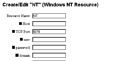

What is a Resource Adapter?
Each resource that you want Identity Manager to communicate with or manage must be defined by a resource object in Identity Manager. Identity Manager requires a resource object for each resource that it must manage. A resource adapter class contains the methods needed to register the resource object in the Identity Manager repository and to manage the external resource.
An adapter’s primary purpose is to define the essential characteristics of this resource type. This information is saved in the Identity Manager repository as a resource object.
Resource objects define the capabilities and configuration of the resource you are managing in Identity Manager, including the information described in the following table.

Your customized adapter provides the means to define these essential characteristics as well as the methods to transform requests from Identity Manager into actions performed on the resource.
Note You can view resource objects from the Identity Manager Administrator Interface from the Debug page.

Windows NT Object Resource Attribute Declarations
The following prototypeXML defines the fields displayed on the Create/Edit Resource page.
<ResourceAttributes>
<ResourceAttribute name='Host' description='The host name running the resource agent.' multi='false' value='n'>
</ResourceAttribute>
<ResourceAttribute name='TCP Port' description='The TCP/IP port used to communicate with the LDAP server.' multi='false' value='9278'>
<ResourceAttribute name='user' description='The administrator user name with which the system should authenticate.' multi='false' value='Administrator'>
<ResourceAttribute name='password' type='encrypted' description='The password that should be used when authenticating.' multi='false' value='VhXrkGkfDKw='>
<ResourceAttribute name='domain' description='The name of the domain in which accounts will be created.' multi='false' value='nt'>
</ResourceAttributes>
Identity Manager Rendering of prototypeXML
The Identity Manager Administrator Interface displays the resource attributes for the default Windows NT resource as specified in the preceding section:
Figure 1. Resource Attributes for Windows NT Resource
