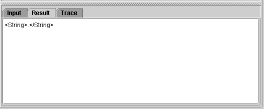

Result Tab
Select the Result tab and click Run (above the Rule source pane) to execute the selected rule. The rule’s return value displays in the Result tab pane in XML format.
Figure 4. Result Tab Pane

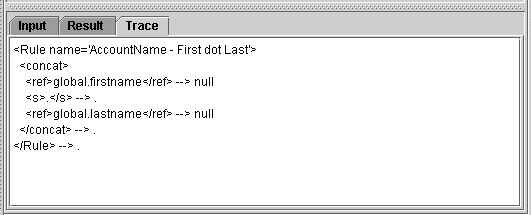

Trace Tab
Select the Trace tab to capture XPRESS tracing during execution of the rule.
Figure 5. Trace Tab Pane

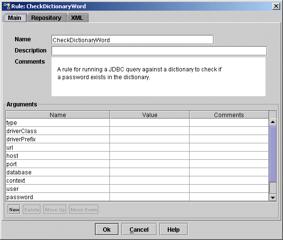

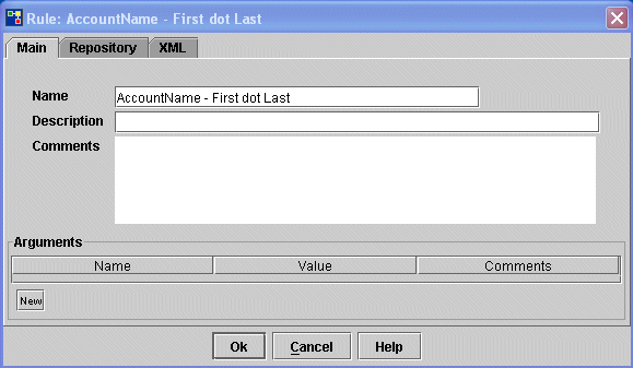

Rule Dialogs
Each rule and rule element has an associated dialog that you can use to define the element type and its characteristics.
To access these dialogs, double-click the rule name in the tree view. The rule dialog for the selected rule displays, with the Main tab in front by default. For example, see the following figure:
Figure 6. Rule Dialog (Main tab view)
You use the options on this dialog to define a rule, as follows:
- Name — Automatically displays the selected rule name, which is the name displayed in the Identity Manager interface.
- Description (optional) — Specify text describing the purpose of the rule.
- Comments — Specify text inserted into the rule body with a <Comment> element.
- Arguments — Specify any required arguments.

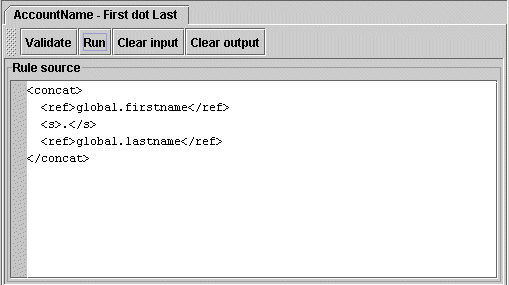

- XML – Displays XPRESS or JavaScript source. You may prefer this display type if you are comfortable with XML.
Figure 8. XML Display

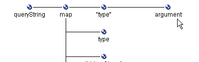

- Graphical – Displays a tree of expression nodes. This display type provides a structural overview.
To conserve space, the following graphic captures only part of the selected rule.
Figure 9. Graphical Display

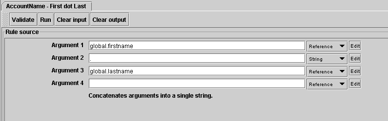

- Property Sheet – Displays a list of properties. Some of these can be edited directly. Other properties may require launching another dialog. For efficiency, use this display type when creating new expressions. (You can enter expression arguments more rapidly in this view than in the graphical view.)
Figure 10. Property Sheet
- Configuration – Displays argument information listed in a property-sheet style. (See the following figure.) Also lists any comments that the rule creator used to describe the rule in the database.
Figure 11. Configuration Display

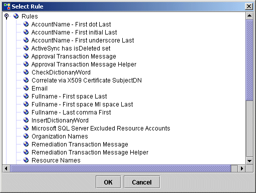

Use one of the following methods to browse and select the rules that you can access through Identity Manager:
- Select File > New Repository Object from the main menu bar. When the Select objects to edit dialog displays, expand the Rules node to display the available rules.
- Right-click in the Rule source pane and select New > Browse Rules from the actions menu.
When the Select Rule dialog opens (see the following figure), expand the Rules node to display the available rules.
Figure 12. Select Rule Dialog

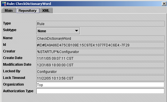

Repository Tab
Note Rules that are not included in a Rule library have a Repository tab.
Select the Repository tab to view the following information about the selected rule.
Figure 14. Repository Tab Display
This tab primarily contains read-only information, but you can change the following values:
- Subtype: Select a new subtype assignment from the menu.
Rules have no subtype by default. Consequently; when you create a rule, the Subtype value defaults to None.
However, to display this rule in the Reconciliation interface, you must set this value to Account Correlation or Account Confirmation, depending upon which selection list in the Reconciliation graphical user interface you would like this rule to appear.
- Organization: Enter a new organization assignment into the text field.
- Authorization Type: Enter a new authorization type into the text field.

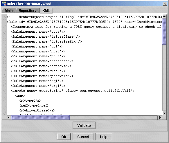

XML Tab
Select the XML tab to view and edit raw XML for the selected rule. You can then click Validate to validate your changes before clicking OK to save. The XML parser validates the rule XML against the waveset.dtd.
Figure 15. XML Tab Display
Creating a New Rule
Use the following steps to create a new rule:
- Select File > New > Rule.
The Rule: New Rule dialog displays, with the Main tab in front by default.
Figure 16. New Rule Dialog
- Specify the following parameters for the new rule:
- Click New to add arguments to the new rule.
- When the Argument: Null dialog displays, enter text into the Name, Value, and Comments fields, and then click OK.
This text displays in the Arguments table and will be inserted into the rule as a <RuleArgument> element.
- When you are finished click OK to save your changes.

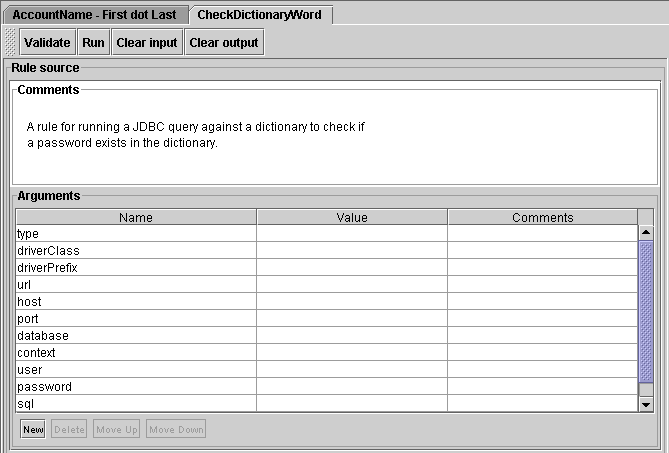

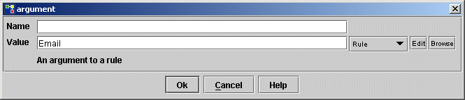

Argument Dialogs
You use an Argument dialog to access and define rule arguments.
Figure 17. Argument Dialog
Use one of the following methods to open an Argument dialog:
- From the Tree view pane, double-click a rule name to open the Rule dialog, and then double-click the argument name on the Main tab.
- From the Rule source pane (in Graphical View only), right-click and select
New > Rule > argument.- From the Rule source pane (in Graphical view only), double-click an argument node.
Figure 18. Double-Click an Argument Node
The Argument dialog provides the following basic options:
Note In addition to these options, the Argument dialog may also display other fields depending upon the type of element you are viewing/editing.
For example, if you are viewing a method element, an Argument dialog similar to the one displayed for the Query method dialog opens:
Figure 19. Argument Popup Dialog (Method)
You can change the argument’s data type by clicking the Change Type button, which displays the Select Type dialog.
Figure 20. Select Type Dialog
Valid argument types are listed in the following table.

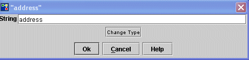

The Element dialog displays the name and value of an argument.
Figure 21. Element Popup for the address Variable

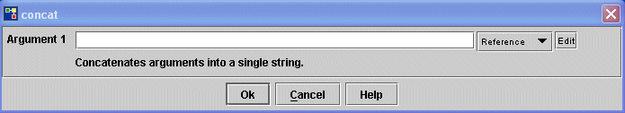

The following figure shows the window that displays when you select New > Strings > concat.
Figure 22. concat Dialog

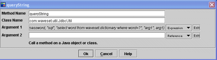

Object Access Dialogs
Right-click in the graphical display, and select New > Other > Object Access > option.
Note See Object Access Dialogs for a discussion of the object access options.
Use to manipulate objects or call Java methods that manipulate objects. Right-click to access the action menu, and select New > Other > Object Access > option, where option can be one of the options described in the following table:
To create an object, right-click to access the action menu, and select New > Other > Object Access > new.
Figure 23. new Dialog

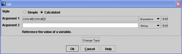

Editing Element Details
From the Argument dialog, you can define values for the variable. Use the Value field to enter a simple string value as the initial variable value. Alternatively, you can select a value type (such as Expression or Rule), and then click Edit to enter values.

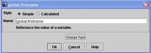

The following graphic shows the variable window for a ref statement.
Figure 24. ref Dialog
To identifying argument types (simple or complex), select Simple when you can enter the argument value in a text field (for example, string, Boolean, or integer). If you are working with a List, XML Object, or other expressions that requires an additional popup, select Calculated.

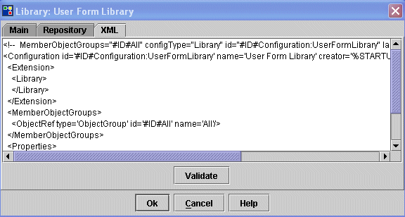

Rule LibrariesA rule library serves as a convenient way to organize closely related rules into a single object in the Identity Manager repository. Using libraries can ease rule maintenance by reducing the number of objects in the repository and making it easier for form and workflow designers to identify and call useful rules.
A rule library is defined as an XML Configuration object. The Configuration object contains a Library object, which in turn contains one or more Rule objects. The following example shows a library containing two different account ID generation rules:

<Rule name='generateEmail'>
<concat>
<ref>global.firstname</ref>
<s>.</s>
<ref>global.lastname</ref>
<s>@sun.com</s>
</concat>
</Rule>This rule references two variables: global.firstname and global.lastname. You could use a rule such as this one in a form that is used with the User view because these are names of attributes in the view. The rule could be called in a Field such as:
