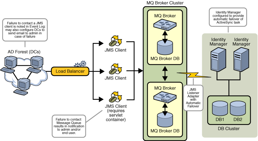

Failover Deployment for Windows PasswordSync
PasswordSync’s architecture provides for the elimination of any single point of failure in the Windows password synchronization deployment for Identity Manager.
If you configure each Active Directory Domain Controller (ADC) to connect to one in a series of JMS clients through a Load Balancer (see the following figure), the JMS clients can send messages to a Message Queue Broker cluster, which ensures that no messages will be lost if any Message Queue fails.
Note Your Message Queue cluster will probably require a database for persistence of messages. (Instructions for configuring a Message Queue broker cluster should be provided in your vendor’s product documentation.)
The Identity Manager server that is running the JMS Listener adapter configured for automatic failover will contact the Message Queue broker cluster. Although the adapter executes on only one Identity Manager at a time, if the primary ActiveSync server fails, the adapter will begin polling for password-related messages on a secondary Identity Manager server and propagating password changes out to downstream resources.

JMS Listener Adapter
The JMS Listener adapter now supports synchronous message processing instead of asynchronous processing. As a result, the second paragraph in the Connections section of the Usage Notes should read as follows:
The JMS Listener adapter operates in synchronous mode. It establishes a synchronous message consumer on the queue or topic destination specified by the JNDI name of Destination field. During each poll interval, the adapter will receive and process all available messages. Messages can be (optionally) additionally qualified by defining a valid JMS message selector string for the Message Selector field.
The Message Mapping section should contain the following:
When the adapter processes a qualified message, the received JMS message is first converted to a map of named values using the mechanism specified by the Message Mapping field. Refer to this resulting map as the message value map.
The message value map is then translated to the Active Sync map using the account attributes schema map. If the adapter has account attributes specified, the adapter searches the message value map for key names that also appear as a resource user attribute in the schema map. If present, the value is copied to the Active Sync map, but the entry name in the Active Sync map is translated to the name specified in the Identity system user attribute column in the schema map.
If the message value map has an entry that cannot be translated using the account attributes schema map, then the entry from the message value map is copied unaltered to the Active Sync map.
