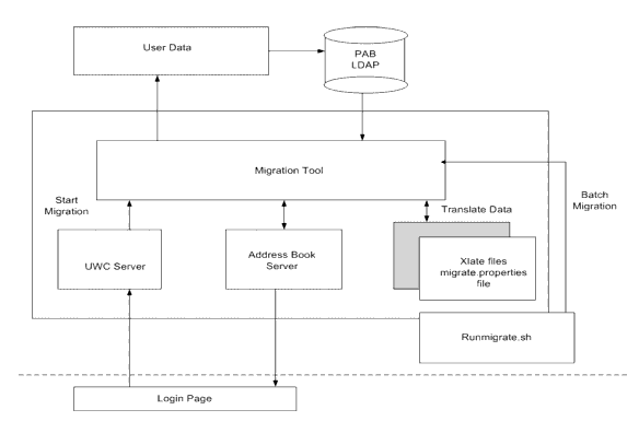

The migration tool migrates user’s Messenger Express address book data to the Addressbook Server that is part of Communications Express.
Figure 7-1 Overview of the Data Migration Process

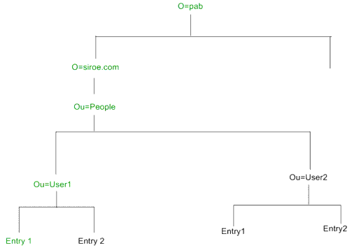

When User1 in the domain siroe.com has an entry in PAB, such as Entry1 that needs to be migrated, the entry is located in the PAB tree under ou=User1 as shown in green in Figure 7-2.
Figure 7-2 Location of Entry1 in the PAB tree

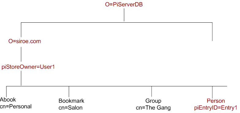

After migration, the newly created Addressbook Server Entry is added to the Addressbook Server tree under o=siroe.com, piEntryID=Entry 1 as shown in red in Figure 7-3.
Figure 7-3 Location of Entry 1 in the Addressbook Server tree.

Dynamic Migration
Dynamic Migration takes place when an existing Messenger Express user logs into Communication Express. The users receive an email after the migration is completed.
In the dynamic migration process:
- The application checks if migration has been enabled in the uwcuath.properties file and then proceeds with the migration process.
- The login logic then compares the nswmextendedprefs attribute with mepabmigration value to determine whether the user’s data has been previously migrated.
- Once PAB migration is completed, the Addressbook Server sets the nswmextendedprefs, mepabmigration to "1" in the logged in user entry, to indicate the completion of the migration process.
- The user receives a mail after the PAB data is successfully migrated to the Address Book Server.
To receive a mail, you are required to define the parameters mentioned in Table 7-2.
Batch Migration
In the batch migration process, migration takes place at the server level without end user interaction. The administrator executes the runMigrate.sh batch script to migrate the mail users PAB data present in a given domain. For mail users present in multiple domains, the administrator will have to invoke the runMigrate.sh script for each domain to migrate users PAB data from the given inetDomainBaseDN to the Address Book Server.
