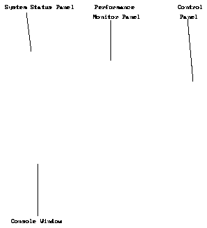

The SunDiag Window
When you start SunDiag in SUNVIEW, the SunDiag window appears on your screen (see Figure C-1). The window is divided into four sections:
    Figure C-1 The SunDiag SUNVIEW window for the SBus Expansion Subsystem
