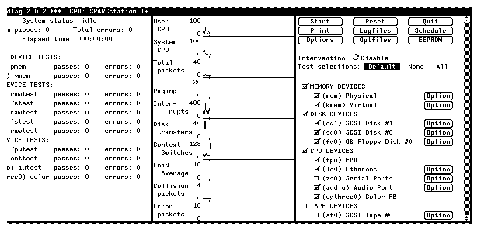

    9. Verify that the drive is indeed defective by running Sundiag.
    You must be logged in as root (superuser) to run Sundiag. The following screen shows you how to use Sundiag to perform some tests on disk and tape drives:
    After a few seconds the following menu will appear on your screen:
    If your DSM contains a disk drive, run rawtest (read and write test) to perform read-only and read-write tests on local disks, using generic SunOS routines. The fstest exercises the disk controller and the disk drive. If your DSM contains a tape drive, you can run tapetest. Please see Sundiag User's Guide for more information.
    The following screen shows you a menu of rawtest and fstest:
To replace a defective drive, see Chapter 5.
The following screen is an example of a menu of tapetest:
To replace a defective tape drive, refer to Chapter 6.
