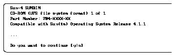

2.3.1 A Typical Installation
This section provides a step-by-step description of the functions performed by the installation script. The margin notes call your attention to lines requiring a response.
Begin installation now? (y/n): y
Executing installation file ...
The following product will be installed:
2.3 Prestoserve
Sun-4 SUNBIN
CD-ROM (UFS file system format) 1 of 1
Part Number: 704-XXXX-XX
Compatible with Sun(tm) Operating System Release 4.1.1 Copyright 1988-1990, Sun Microsystems, Inc. All Rights Reserved. Based on the SunOS Release. Derived from UNIX and Berkeley 4.3 BSD licensed from AT&T Information Systems Inc. and the Regents of the University of California, respectively. Sun considers its source code as an unpublished, proprietary trade secret, and it is available only under strict license provisions. This copyright notice is placed here only to protect Sun in the event the source is deemed a published work. Disassembly, decompilation, or other means of reducing the object code to human readable form is prohibited by the license agreement under which this code is provided to the user or company in possession of this copy. RESTRICTED RIGHTS LEGEND: Use, duplication, or disclosure by the Government is subject to restrictions as set forth in subparagraph (c)(1)(ii) of the Rights in Technical Data and Computer Software clause at DFARS 52.227-7013 (Oct. 1988) and FAR 52.227-19(c) (June 1987). Sun Microsystems, Inc., 2550 Garcia Avenue, Mountain View, California 94043.
Do you want to continue [y|n]? y /cdrom/2.3_Prestoserve/../bin/extract_unbundled : Extracting Installation Scripts /cdrom/2.3_Prestoserve/../bin/extract_unbundled : Begin Install Script Execution Invoking /usr/tmp/unbundled/2.3_Prestoserve; log file is /usr/tmp/unbundled/2.3_Prestoserve.log
