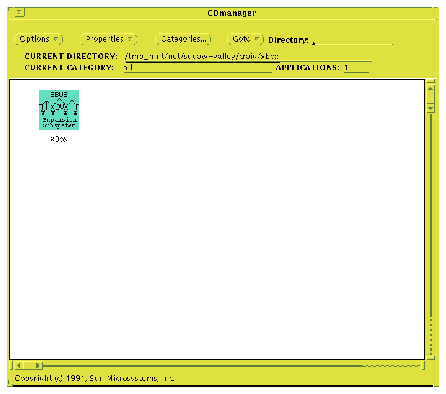

After a few moments, the CDmanager base window shown in Figure 2-1 appears.
    Figure 2-1 CDmanager base window

    1. Move your cursor to the SBus Expansion Subsystem icon and click the SELECT key.
After you press the SELECT key, the system will darken the icon (Refer to Figure 2-2) and put it into a box frame.
