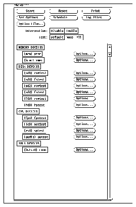

1. Review the information shown in the control panel window. The
information in the control panel identifies the devices that are available
for testing. Refer to Figure 2-2.
2. Click on the device that you want to test, for example DISK DEVICES.
Your selection is confirmed with the display of a check mark in the box
next to the device name.
Figure 2-2
Sundiag Control Panel
3. Click on the OPTION button, opposite the device name, to display a
pop-up option menu. Refer to Figure 2-3.
4. Use the mouse to select your test options. A check mark identifies that the
item is selected.
Figure 2-3
Pop-Up Option Menu
