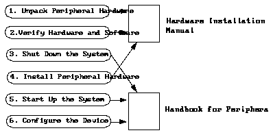

Task Map for Installing the Drive
The diagram below outlines the tasks you can perform to successfully install a new peripheral. Each numbered item in the diagram represents a procedure and the arrows point to the specific manual in which these procedures are detailed.
After you perform these tasks, you will be ready to use the new peripheral with your system.
