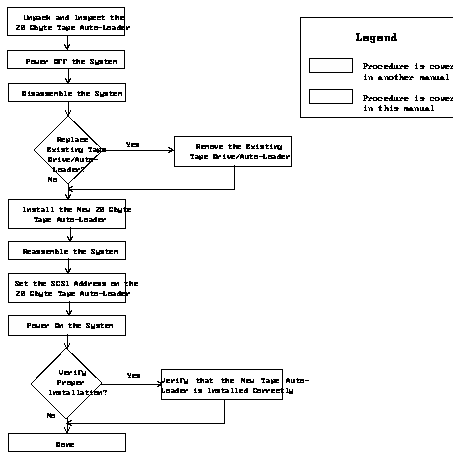

The procedures to install or replace the drive are shown in Figure 1-1. These procedures are explained in greater detail in each system-specific chapter.
    Figure 1-1 The Installation Procedures for a 20 Gbyte 4 mm Tape Auto-Loader

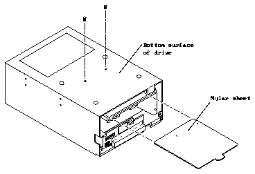

1.5 Removing the Mylar Sheet
    1. Turn the auto-loader upside down and remove the two screws that secure the mylar sheet to the auto-loader. See Figure 1-3.
    There are six screws on the bottom of the auto-loader; remove only the two screws that protrude slightly.
    Figure 1-3 Removing the Mylar Sheet from the Auto-Loader
    2. Grasp the clear plastic tab at the rear of the auto-loader and pull the mylar sheet out of the drive. See Figure 1-3.
    Save the mylar sheet and the two screws. If you ship the unit at a later date, reverse these steps to replace the mylar sheet in the unit.

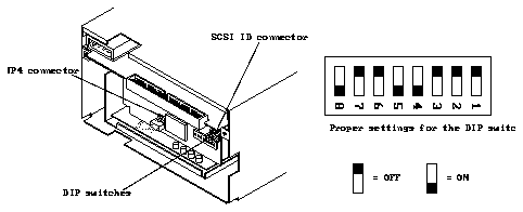

1.6 Verifying Jumpers and DIP Switches
    1. If jumpers are installed on the SCSI ID connector, use the needle-nose pliers to remove them. See Figure 1-4.
    Figure 1-4 SCSI ID, JP4 Connector and DIP Switches on the Drive
    2. Verify that the DIP switches at the rear of the drive are set to the proper positions. See Figure 1-4.
    3. Verify that the JP4 connector either has a jumper installed vertically or no jumper at all. See Figure 1-4.
    The JP4 connector should not have a jumper installed horizontally over both pins.

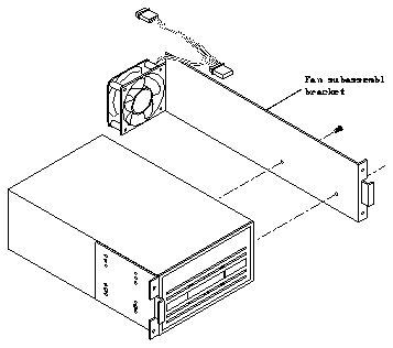

1.7 Attaching the Mounting Brackets
Attach the left and right brackets to the drive as follows:
    1. Attach the shorter bracket to the left side of the auto-loader using two M3 screws. See Figure 1-5.
    Figure 1-5 Attaching the Left Bracket
    2. Align the fan subassembly bracket along the right side of the auto-loader.
    The fan will be at the rear of the unit when the bracket is properly aligned.
    3. Attach the bracket to the auto-loader using two M3 screws. See Figure 1-6.
    Figure 1-6 Attaching the Fan Subassembly Bracket

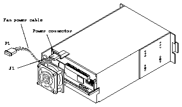

    4. Plug one end of the fan power cable (J1) into the power connector on the rear of the auto-loader. See Figure 1-7.
    This cable is hardwired to the fan.
    Figure 1-7 Connecting the Fan Power Cable to the Auto-Loader
