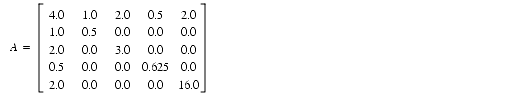

c  Sparse matrix structure and value arrays.  From George and Liu,
c  page 3.
c    Ax = b, (solve for x) where:
c
c      4.0   1.0   2.0   0.5   2.0       2.0       7.0
c      1.0   0.5   0.0   0.0   0.0       2.0       3.0
c  A = 2.0   0.0   3.0   0.0   0.0   x = 1.0   b = 7.0
c      0.5   0.0   0.0   0.625 0.0      -8.0      -4.0
c      2.0   0.0   0.0   0.0  16.0      -0.5      -4.0
c
      data colstr / 1, 6, 7, 8, 9, 10 /
      data rowind / 1, 2, 3, 4, 5, 2, 3, 4, 5 /
      data values / 4.0d0, 1.0d0, 2.0d0, 0.5d0, 2.0d0, 0.5d0, 3.0d0,
     &              0.625d0, 16.0d0 /
      data rhs    / 7.0d0, 3.0d0, 7.0d0, -4.0d0, -4.0d0 /
      data xexpct / 2.0d0, 2.0d0, 1.0d0, -8.0d0, -0.5d0 /
c  page 3.
c
c
