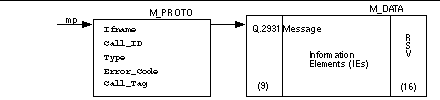

The Q.93B driver is an M-to-N mux STREAMS driver. Multiple application programs can be plumbed above the driver, and multiple physical interfaces can be connected below Q.93B. Applications can access any or all of the physical interfaces, and messages received on the physical interfaces can be directed to any of the applications. To direct messages through the Q.93B driver, messages from applications must include a physical interface name to identify the outgoing interface and a SAP to identify the application to which the message should be directed on the receiving host.
Send messages to Q.93B by applications according to the format illustrated in Figure A-1; kernel applications use putnext(9f) to send the mblocks shown and user applications send two corresponding strbufs using putmsg(2).
Figure A-2 Message Format
Graphic
Table A-2 Fields in the M_PROTO mblock

The structure included in the M_PROTO mblock is defined as the qcc_hdr_t structure in the <atm/qcctypes.h> header file. In the second mblock, the Q.2931 header portion (9 bytes) of the Q.2931 message is blank and later filled in by the Q.93B driver. The application should also reserve 16 bytes at the end of the second mblock for the layer 2 (Q.SAAL) protocol performance. The qcc functions can be used to create messages in this format.
