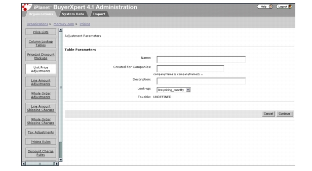

Follow these guidelines to create a pricing adjustment using the Admin interface (field and procedure details are contained in Help):
  1. Select Pricing>Unit Price Adjustments.
  2. Select New Table (Blank) to create a totally new pricing adjustment table.
    OR
    Click an existing table and select New Table (Copy Selected) to copy an existing table that you will modify and save under a new name.
  3. Enter the name of the adjustment, the name (s) of the organization(s) for which the adjustment can be used, and the description.
  4. Choose Look-up (the condition which will be used to calculate adjustment amount) from the drop-down menu.
  5. Click Continue.

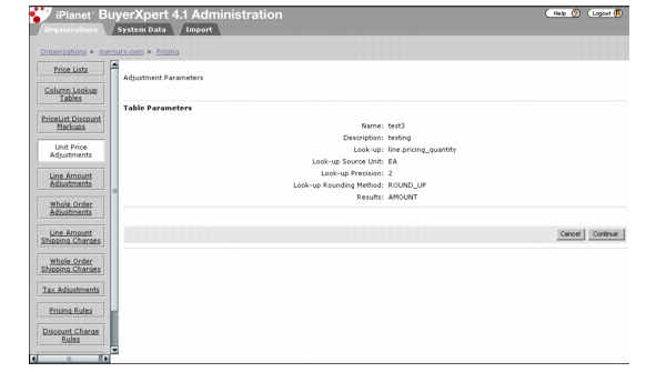

  6. Choose the look-up unit.
  7. Enter look-up precision and choose the look-up-rounding method.
  8. Choose results amount or percentage.
  9. Click Continue.
  10. The pricing adjustment results are applied to line.gross_price. If you have chosen a percentage, the resulting adjustment will be a percentage of line.gross_price.
  11. Click Continue.

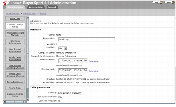

  12. Click Save and Continue.
  13. Enter the appropriate look-up condition and result value.
  14. Click Add.
  15. Repeat the previous step for all the look-up conditions.
  16. When done, change the Effective-from and Effective-until dates as needed.
  17. Set Enabled to YES to enable the adjustment.
  18. Click Save Changes.

Defining a Column Lookup Table
Follow these guidelines to create a column lookup table using the Admin interface (field and procedure details are contained in Help):
  1. Select Pricing>Column Lookup Tables.
  2. Select New Table (Blank) to create a totally new column lookup table.
    OR
  3. Follow procedures in Help to complete the task.
Creating a Column Lookup Table Adjustment
This adjustment is optional. If a column lookup table adjustment is not used, the default price column rule is applied.
After the price list columns are set up, you can set up adjustments which determine the column to be looked up in the price list.You can do this in the Pricing>Column Lookup Tables screen.
You can set up such situations as this: If the quantity ordered in more than 100 items, use column 2, which is the deeply discounted price. However, if the buyer only orders 10 items, use column 3 of the price list, which is not as deep a discount.

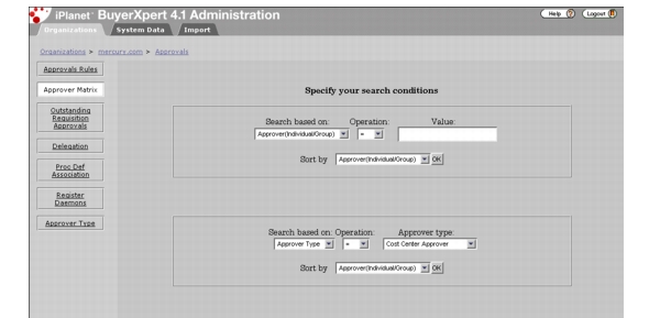

  1. Select Approvals>Approval Rules>Approver Matrix Types.
    The list of rule instances displays.
  2. Choose the user or group you want to create the rule for.
  3. Enter the conditions needed.
This is where you create the rule. Existing approver types (as created using the Approver Type link) appear in the left scrollbox.
  1. Select the types you want in the right scrollbox.
  3. Click Save Changes.
The new rule has been created.

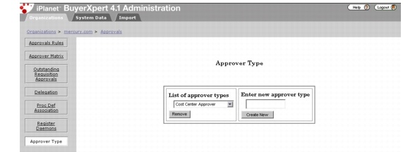

*Creating Approval Rules
  1. Select Approvals>Approver Type.
  2. Add the approver types:
    • Cost Center Approver
    • Commodity Code
    • Off-Catalog Approver
  3. Set up the approval limit rule by selecting Approvals > Approvals Rules > Approval Limit. Make sure you add a default rule for the whole organization in addition to adding specific limits for specific approvers.
    Note If you don't set up a default rule, you might not be able to see the approval graph.
  4. Set up the Approval Matrix with the cost center approvers.
