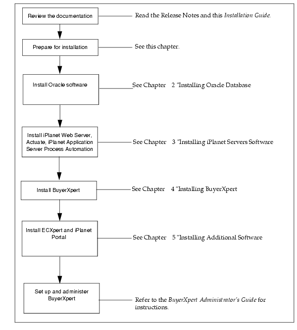

Installation Roadmap
This roadmap lists the tasks you must complete in order to successfully install and configure BuyerXpert. For your convenience, the roadmap points to the chapter or to another manual that includes the information you need to complete each task.
