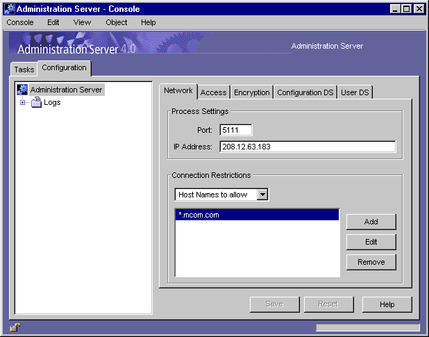

To change the configuration Directory Server settings:
In Netscape Console, choose an Administration Server and open it.
Click Configuration.
Click Configuration DS.
Modify settings as appropriate.
LDAP Host.
Enter the host name of the configuration directory this Administration Server uses.
LDAP Port.
Enter the port number for the configuration directory this Administration Server uses.
Use SSL.
Select this option if the new configuration directory is already SSL enabled.
Click Save.

Changing User Directory Settings for a Server Group
To change the user Directory Server settings for a server group:
Click User DS.
Use Default User Directory.
Choose this option if you want to use the default user directory associated with the domain.
Set User Directory.
Choose this option if you want to use a user directory other than the default associated with the domain.
LDAP Host and Port.
Specify the location of the user directory using the host computer's fully qualified domain name and port number. For authentication purposes, you can enter more than one user directory location separated by spaces.
Example:
Eros.Airius.com:389 Zeus.Airius.com:389
See "User Authentication and Directory Failover Support" on page 142 for
more information
If you specify more than one host computer, each one must be configured
identically regarding the following settings:
Secure Connection.
Select this option if the new user directory port is already enabled for SSL communication.
User Directory Subtree.
Enter the location of the new user directory. Example: o=mcom.com
Bind DN.
Enter the distinguished name for a user who has access permisions to the new user directory. Example: uid=ginac, ou=people, o=Airius.com.
Bind Password.
Enter the password of the user above.
Click OK.
