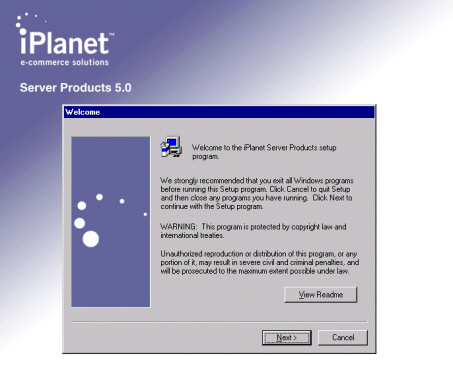

To Install iPlanet Console as a Stand-Alone Application on Windows NT Systems
  1. Download the compressed product binaries for iPlanet Console.
    The binary files are available at this location: http://www.iplanet.com/downloads/patches
  2. Extract the binaries into a new folder and run the setup.exe program.
    The installation startup screen appears.
  3. Proceed through the installation process. Here are the prompts you encounter with instructions about what to do:
  4. Do you accept all of the terms of the preceding license agreement? Click Yes.
  5. Choose the type of Setup you prefer. Select iPlanet Console.
  6. Installation directory. Enter the location where you want to install iPlanet Console. If this folder does not exist, the Setup program asks if you want to create it.
  7. Review your selections. If you need to make any changes, click Back and modify your choices.
  8. Click Install.
    The Setup program installs iPlanet Console in the specified folder.
  9. When the installation is complete, click Finish.
Once installation is complete, you can run iPlanet Console by clicking Start, and then choosing Programs > iPlanet Server Products > iPlanet Console 5.0.
