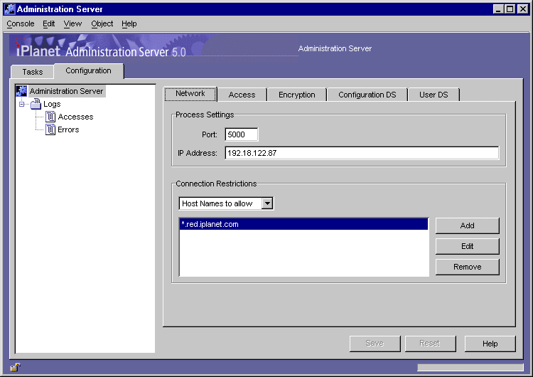

Network settings affect the way an instance of iPlanet Administration Server runs. By default, these settings are configured automatically during installation, but you can modify them if your system configuration changes. You can change the following settings:The port number specifies where an instance of Administration Server listens for messages. It can be any number between 1 and 65535 but, to avoid conflicts with other resources, it is typically a number greater than 1024. For security reasons, consider changing the port number regularly.
Connection restrictions allow you to specify which hosts are allowed to connect to an instance of Administration Server. You can list these hosts by DNS name, IP address, or both. You can use the * wildcard to specify a group of hosts. For instance, entering *.siroe.com allows all machines in the siroe.com domain to access the instance. Entering 205.12.*. allows all hosts whose IP addresses begin with 205.12 to access the instance. When specifying IP address restrictions, you must include all three separating dots. If you do not, you will receive an error message.
From the iPlanet Console navigation tree, select the instance of Administration Server that you want to configure.
Click Open to open the management window for the instance of Administration Server.
Click the Configuration tab, and then click the Network tab.
Click OK.
- Port. Enter the port number you want this instance of Administration Server to use. The port number can be any number between 1 and 65535. However, to avoid conflicts with other resources, the port number is typically a number greater than 1024.
- Connection Restrictions. Displays a list of hosts allowed to connect to this instance of Administration Server. Use the drop-down list to specify whether you're adding to the list by DNS name or by IP address. The list is evaluated first by host names, and then by IP addresses.
- Add. Click if you want to display a dialog box for adding a host to the list of computers allowed to connect to this instance of Administration Server.
- Edit. Click if you want to display a dialog box for editing a Host IP address or DNS name on the list of computers allowed to connect to this instance Administration Server.
- Remove. Click if you want to remove a selected entry from the list of allowed hosts.

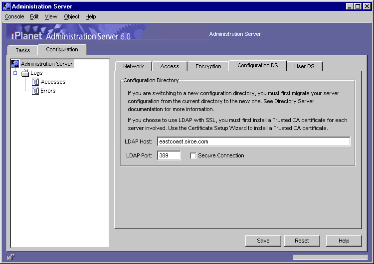

Directory Settings
Directory settings tell the Administration Server where to find the configuration directory and the user directory.
The Configuration Directory
When you install an iPlanet server, you are prompted for the location of an instance of Directory Server in which to store configuration data. Depending on the way your organization uses directories, you specify either an instance of Directory Server that contains only configuration data or an instance of Directory Server that contains both user and configuration data.Configuration data is stored under o=NetscapeRoot in the instance of Directory Server that you specify during installation. This subtree is called the configuration directory and contains server settings such as network topology information and server instance entries. When you install a server or change its configuration, the new settings are stored in the configuration directory subtree.
Changing the Host or Port Number
You can designate a different host or port number for the instance of Directory Server containing the configuration directory subtree.
To Change the Host or Port Number
In the iPlanet Console navigation tree, select the instance of Administration Server that you want to change configuration Directory Server settings for.
Click the Configuration DS tab.
Modify settings as appropriate:
Click Save.
- LDAP Host. Enter the host name of the configuration Directory Server this instance of Administration Server uses.
- LDAP Port. Enter the port number for the configuration Directory Server this instance of Administration Server uses.
- Secure Connection. Check this box if you want to connect securely with the configuration Directory Server. Before choosing this option, make sure the configuration Directory Server running on the specified LDAP Host and LDAP Port already has SSL activated on it.

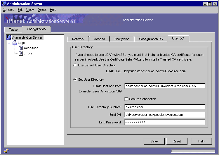

The User Directory
The user directory is stored in a Directory Server subtree that you create. The user directory is used for authentication, user management, and access control. It stores all user and group data, account data, group lists, and access control instructions (ACIs).You can have more than one user directory in your enterprise. For example, to increase directory performance, one company might deploy three user directories, one in each of three geographic regions. Another company might deploy five user directories, one for each of five Mail Servers. You can configure an instance of Administration Server to authenticate users against multiple user directories.
If the user and configuration directory subtrees are in different instances of Directory Server, you need to activate pass-through authentication.
User Directory Settings
When you're installing an iPlanet server, you are prompted to specify a user directory that is associated with the administration domain in which the server will be located. By default, this association is inherited at all levels beneath the administration domain. Server groups and the individual servers within them use the same user directory as the domain.There may be times when you need to override default user directory settings at the server group or domain level. For example, you may need to change the user directory for a domain when you upgrade to a new Directory Server. Or you might want to temporarily change the user directory for a server group when you're testing a new instance of Directory Server and don't want to use your existing user directory with it.
User Authentication and Directory Failover Support
When a user logs in to iPlanet Console, the user enters a user ID that is checked against the user directory. If the user ID cannot be authenticated in a user directory, the user cannot successfully log in to iPlanet Console.You can employ more than one user directory for authenticating user IDs. This is useful when the instance of Directory Server containing your primary user directory is not accessible. If the user directory has been replicated on other hosts, iPlanet Console continues to check the user ID against each user directory in the list until authentication succeeds or there are no more entries in the list. This ability to check multiple instances of Directory Server is called failover support.
To list the user directories to use for failover support, follow the instructions for "Changing User Directory Settings for a Domain" or "To Change User Directory Settings for a Server Group." For information on replicating the user directory, see the Directory Server Administrator's Guide.

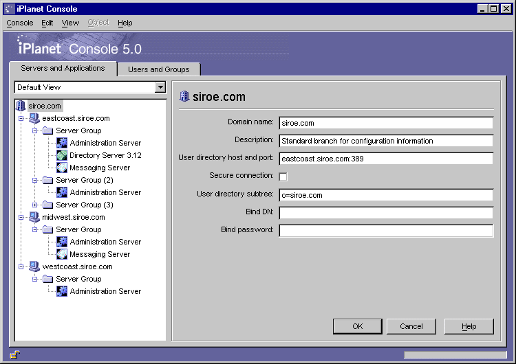

If you are the configuration administrator, you can change the user directory settings for a domain.
To Change the User Directory Settings for a Domain
In the iPlanet Console navigation tree, select the administration domain that you want to change user directory settings for.
In the right-hand panel of the main iPlanet Console window, click Edit.
Modify domain information as appropriate.
Click Save.
- Domain name. Enter a domain name. Example: eastcoast.siroe.com
- Description. Enter a name that helps you identify this domain.
- User directory host and port. Specify the location of the new user directory using the host computer's fully qualified domain name and port number. For authentication purposes, you can enter more than one user directory location separated by spaces. Example:
- eastcoast.siroe.com:389 westcoast.siroe.com:4332
- See "User Authentication and Directory Failover Support" for more information.
- If you specified more than one location in the "User directory host and port" field, the settings for the remaining fields will apply to them all.
- Secure connection. Check this box if you want to connect securely with the user directory. Before choosing this option, make sure the instance of Directory Server is running on the specified user directory host and port already has SSL activated on it.
- User directory subtree. Enter the location of the new user directory. Example: o=siroe.com
- This subtree must contain the user directory in all the locations specified in the "User directory host and port" field.
- Bind DN. (Optional) Enter the distinguished name for a user who can access the new user directory. Example: uid=john, ou=people, o=siroe.com.
- Bind password. (Optional) Enter the password of the user specified by the Bind DN.
In the iPlanet Console navigation tree, click + to expand the server group that you want to change user directory settings for.
Select the instance of Administration Server in the server group.
Modify settings as appropriate.
Click Save.
- Use Default User Directory. Select this option if you want to use the default user directory associated with the domain.
- Set User Directory. Select this option if you want to use a user directory other than the default associated with the domain.
- LDAP Host and Port. Specify the location of the user directory using the host computer's fully qualified domain name and port number. For authentication purposes, you can enter more than one user directory location separated by spaces.
- Example:
- If you specified more than one location in the "LDAP Host and Port" field, the settings for the remaining fields will apply to them all.
- Secure Connection. Check this box if you want to connect securely with the user directory. Before choosing this option, make sure the instance of Directory Server is running on the specified user directory host and port already has SSL activated on it.
- User Directory Subtree. Enter the location of the new user directory. Example: o=siroe.com
- This subtree must contain the user directory in all the locations specified in the "LDAP Host and Port" field.
- Bind Password. (Optional) Enter the password of the user specified by the Bind DN.
