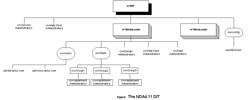

In order to support user directories that are already deployed, Delegated Administrator 4.5 uses a new, highly flexible DIT model. It defines a new grammar that is capable of creating an abstract representation of the user tree which can be interpretted by the back end. By making a few changes in your existing user directory, and representing your existing tree in terms of the new grammar, you can use Delegated Administrator 4.5 to with the user directory you created using version 4.11.Figure B-1 illustrates the default DIT used in Delegated Administrator 4.11.
Figure B-1    Default DIT used in Delegated Adminstrator 4.11 ![]()

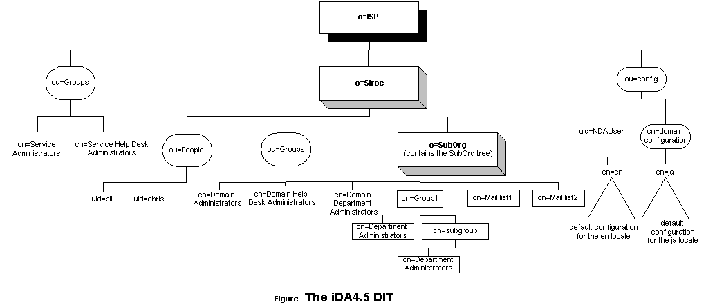

Changes and additions were necessary to introduce flexibitlity in the support of arbitrary DITs. Figure B-2 illustrates the resulting default DIT used in Delegated Administrator 4.5.
Figure B-2    Default DIT in Delegated Administrator 4.5 ![]()
