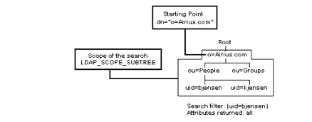

Figure 6-1 illustrates how search criteria works.
scope specifies the scope of the search (which entries you want to search).
- To search entries under "o=airius.com", the base DN is "o=airius.com". See "Specifying the Base DN and Scope" for details.

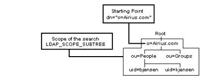

LDAP_SCOPE_SUBTREE searches the base entry and all entries at all levels below the base entry (as illustrated in Figure 6-2).
Figure 6-2    Example of a search with the scope LDAP_SCOPE_SUBTREE

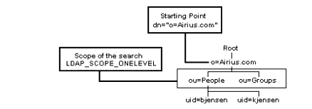

LDAP_SCOPE_ONELEVEL searches all entries at one level below the base entry (as illustrated in Figure 6-3). The base entry is not included in the search. Use this setting if you just want a list of the entries under a given entry. (See "Listing Subentries" for an example.)
Figure 6-3    Example of a search with the scope LDAP_SCOPE_ONELEVEL

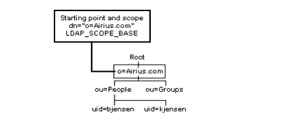

LDAP_SCOPE_BASE searches only the base entry. Use this setting if you just want to read the attributes of the base entry (as illustrated in Figure 6-4). (See "Reading an Entry" for an example.)
Figure 6-4    Example of a search with the scope LDAP_SCOPE_BASE

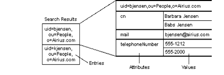

Figure 6-5 illustrates the relationship between entries, attributes, values, and search results.
Figure 6-5    Search results in terms of entries, attributes, and values

Getting the Values of an Attribute
The values of an attribute are represented by a NULL-terminated array. The values are either a list of strings (if the attribute contains string data, such as a name or phone number) or a list of berval structures (if the attribute contains binary data, such as a JPEG file or an audio file).
To get the values of an attribute that contains string data, call the ldap_get_values() function.
To get the number of values in an attribute, call the ldap_count_values() or ldap_count_values_len() function. Both functions return the number of values in the attribute.
To get the values of an attribute that contains binary data, call the ldap_get_values_len() function.
- The ldap_get_values() function returns a NULL-terminated array of strings representing the value of the attribute.
When you have finished working with the values of the attribute, you need to free the values from memory. To do this, call the ldap_value_free() or ldap_value_free_len() function.
The following section of code gets and prints the values of an attribute in an entry. This example assumes that all attributes have string values:

Reading an Entry
You can use the search functions to read a specific entry in the directory. To read an entry, set the starting point of the search to the entry, and set the scope of the search to LDAP_SCOPE_BASE and specify (objectclass=*) for the search filter.
Figure 6-6    Using the LDAP_SCOPE_BASE scope to read an entry
The following section of code prints the attributes of the entry for Barbara Jensen.
Listing Subentries
You can use the search functions to list the subentries under a specific entry in the directory. To list the subentries, set the starting point of the search to the entry, and set the scope of the search to LDAP_SCOPE_ONELEVEL.
Figure 6-7    Using the LDAP_SCOPE_ONELEVEL scope to list subentries
The following section of code lists all entries one level below the o=airius.com entry in the directory hierarchy.
