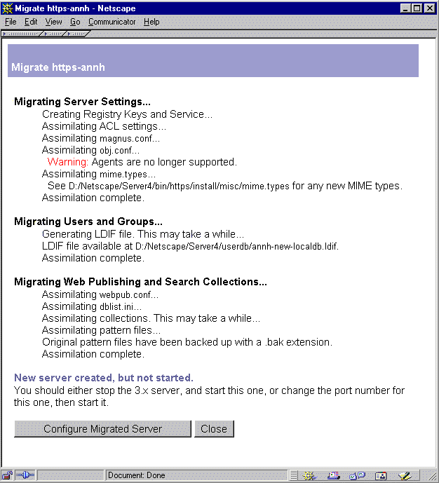

The Migrate Server Page
When you migrate, you see a page (Migrate Server_name) that logs all the migration information, including all errors encountered. The following is an example of this page.
Figure 4.1    Migration information
As shown in this example, you receive warnings for the features you used in Netscape Enterprise Server 3.6 that are not supported in iPlanet Web Server 4.1. The migration program does not migrate entries in obj.conf that are for obsolete features.
If you get fatal errors while migrating, the migration continues. The results page shows what errors occurred an you can use this information to troubleshoot.
