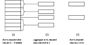

Specifying Conditions on Aggregate Rows
You can impose two kinds of conditions as part of a query:
Conditions on the rows retrieved from the database. These conditions are specified in the SetWhere( ) method. See Specifying Conditions on Row Retrieval.
When a query runs, it follows the steps described in the following illustration and list.Conditions on aggregate rows. These conditions are specified in the SetHaving( ) method, which is described in this section.
The query first retrieves rows from the database as specified in the SELECT and FROM clauses. Only rows that meet the conditions in the WHERE clause are retrieved at this point.
To specify conditions on aggregate rows, use the SetHaving( ) method. This method can refer to any fields in the aggregate rows to set up criteria. Before you call SetHaving( ), you must call SetGroupBy( ) to create the aggregate rows. For example:If the query includes a GROUP BY clause, the query's result set contains aggregate rows. Each aggregate row summarizes the data in several of the rows from the database. For information about how to create aggregate rows, see Summarizing Data.
The query finally applies the conditions in the HAVING clause to the aggregate rows.
pQry->SetFields("CustName, Avg(OrderTotal) as AverageAmt");
pQry->SetHaving("AverageAmt > 1000");
If you call SetHaving( ) more than once in the same query, each subsequent call replaces the settings specified in the previous call. To add more conditions on aggregate rows, list all of them in a comma-separated list in a single SetHaving( ) call.
The information in the SetHaving( ) call corresponds to the HAVING clause of a SQL SELECT statement. Use the SQL HAVING syntax to specify conditions. The method call can include any valid SQL syntax, including nested SELECT statements. For more information about the HAVING clause, refer to your SQL documentation.

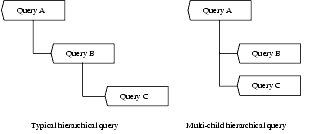

Typically, each parent query has a single child query, so each AddQuery( ) call represents a new level of nesting. For an example of this type of hierarchical query, see Example Two-Level Hierarchical Query.
A parent query can also have several child queries, as shown in the following illustration:
In a multi-child hierarchical query, several AddQuery( ) calls refer to the same parent query. The result is parallel subreports whose results are displayed one after the other. For an example of this type of hierarchical query, see Sample Multi-Child Hierarchical Query.
