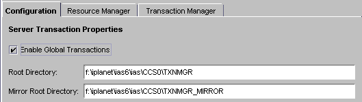

Configuring Transactions per Server
To change transaction settings for an application server, click a registered server in the left pane of the Transaction window. The Configuration tab appears in the right pane as shown here:
You can set the transaction mode. When global transactions are enabled, transactions can span across multiple heterogeneous databases and processes. When you clear the Enable Global Transactions checkbox, local transactions are enabled. Local transactions are limited to a single database/process but offer overall improved server performance over global transactions.
The selected server's current root and mirror directories are listed on the Configuration tab. Since no error checking is provided, it is not recommended that you edit these directories.

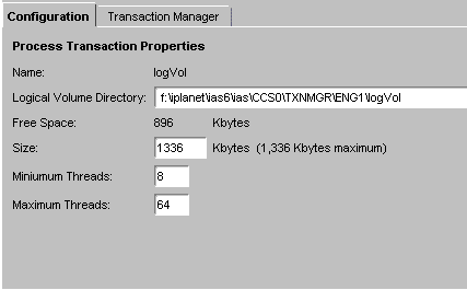

Configuring Transactions per Process
Click the process in the left pane of the Transaction window to change transaction settings for a process on an application server.
The Configuration tab appears in the right pane as shown in the following illustration:
The logical volume size for the process is displayed. You can set the size of the logical volume by entering a number in the Logical Volume Size field. A logical volume must be between 8 MB and 10 MB.

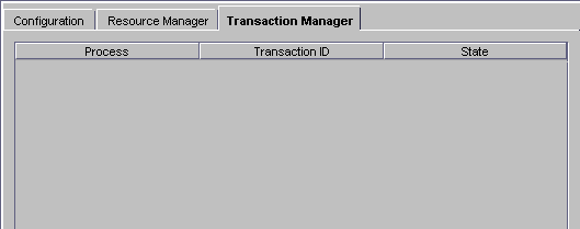

Viewing Transactions on a Selected Process
Click the Transaction Manager tab to view the details of all transactions running on the selected process. The following window appears:
The transaction ID and state appear. See for more information.

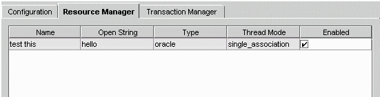

Configuring Resource Managers
A resource manager enables you connect to a database back end for global transactions. If you enable a resource manager, the transaction manager within a KJS process attempts a connection to the database when the KJS process is started.There is one resource manager for each database the application server can access. Click the Resource Manager tab in the Transaction window to configure resource managers. The following window appears:
The name of each resource manager (for instance, Microsoft SQL) as well as its status (enabled or disabled) is displayed. Click the Enabled checkbox to toggle the status of each resource manager. Note that you must restart the server before changes to your resource manager configuration take effect.

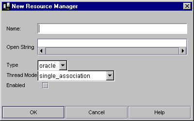

Adding and Editing Resource Managers
To add or edit Resource Managers, perform the following steps:
Click the Add or Modify buttons to add or edit a resource manager. The following dialog box appears:
In the Name field, enter a value to distinguish the selected resource manager from other resource managers.
In the OpenString field, enter the parameters for accessing a particular database (user name, password, permissions).
Select the type of database from the Type drop-down box (for instance, Microsoft SQL).
Choose the thread mode from the drop-down box:
multiple_associations: the transaction manager XA (TM-XA) service performs no serialization of XA operations between threads.
Finally, to enable or disable the resource manager, click the Enabled checkbox.serialize_all_operation: the TM-XA service permits a maximum of one thread to make an XA call to the resource manager client library at a time.
serialize_start_end: the TM-XA service ensures that only one association with the resource manager client library is attempted at a time.
single_association: the TM-XA service does not prevent multiple threads from attempting different associations at the same time.
- Only one resource manager may be enabled for each database type.
- You must restart the server before changes take effect.

From the iAS Administration Tool toolbar, click the Transactions button to open the Transactions window.
For Oracle resource managers, if you encounter a "lock held by distributed transaction" error, you must connect to the database and rollback the global transaction explicitly. To do so, perform the following steps:Click the Transaction Manager tab.
Select the transaction that you want to force and click Details.
Click the Resolve/Abort button to force rollback the transaction.
