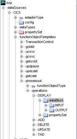

Creating the Function Object
A function object is a group of related operations that share a common state. In UIF, a function object is set up and associated with a service provider before the function object is executed.
Detailed Description of Function Object
A function-object contains operations. The operations contain data-block definition and a property set whose values define access to the target CICS transaction. The data objects contain actual data values which are in the format specified in a data type. The data object element under a function object template is a data object of a specified data type. It represents the parameter block for the operation and holds the input/output information during the execution of the operation.The following diagram shows the parts of a function-object type.
Figure 3-5    Function-Object Type
The following is an example of how to create a function object.

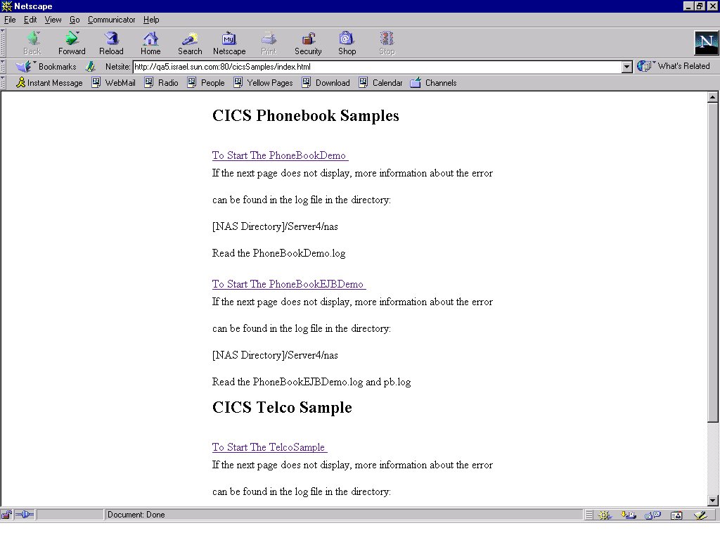

Samples
This section describes the three samples that are included: two Phonebook and one Telco.
Telco Sample and Programming Concepts
This sample is based on CICS and DB2 for OS/390.The Telco sample application consists of seven (7) CICS programs that access DB2 tables.

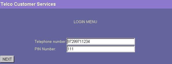

Type your telephone number and PIN number in the Login Menu dialog box

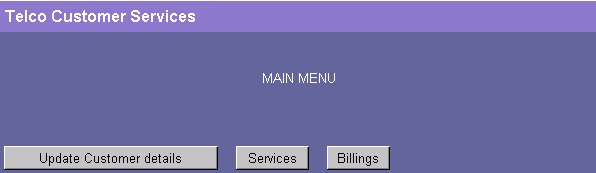

.Click the Next button to display the Telco Customer Service Main Menu.

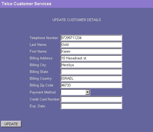

Click on the Update Customer detail button.The Customer Details dialog box, shown below, is used to update the name, address, and telephone number of the customer. Payment method, credit card number, and credit card expiration date are not displayed and cannot be changed.
Type the change in the appropriate text box. In the dialog box, below, a new billing address has been typed into the Billing Address text box: 22 Herzl St
.Click the Update button to save the data.

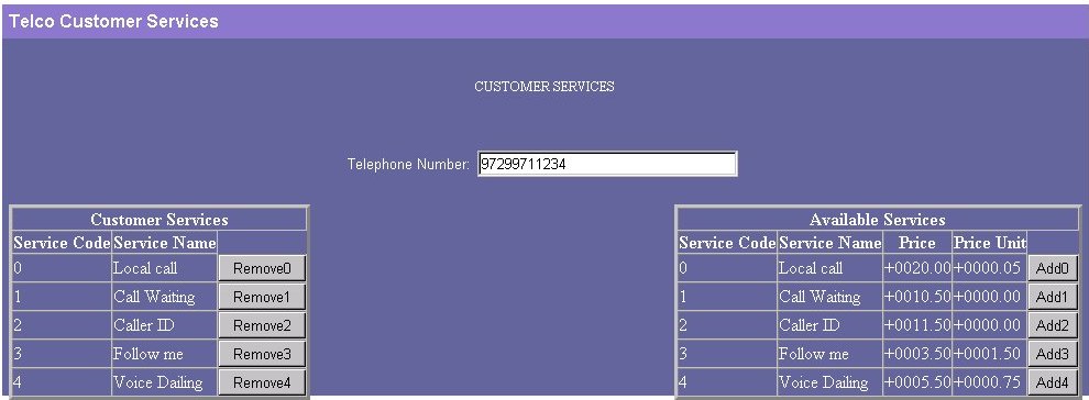

Displaying the Customer Services
From the main menu press the Customer Services button.The following dialog box appears.![]()

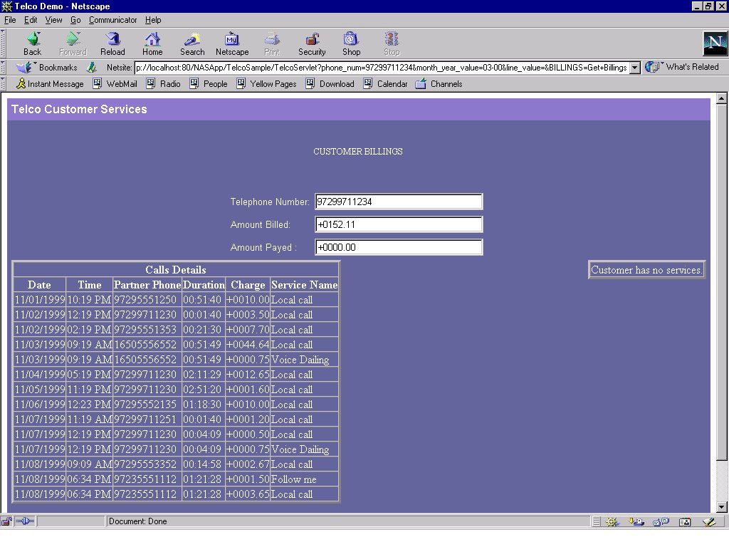

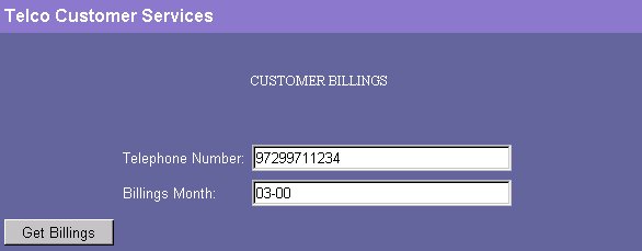

Displaying the Customer's Billing for Any Month
Type the telephone number and billing month in the appropriate text boxes.
Press the Get Billings button to display the billings, as shown below.
Press the Get Billings button to see the billings, as shown below.
