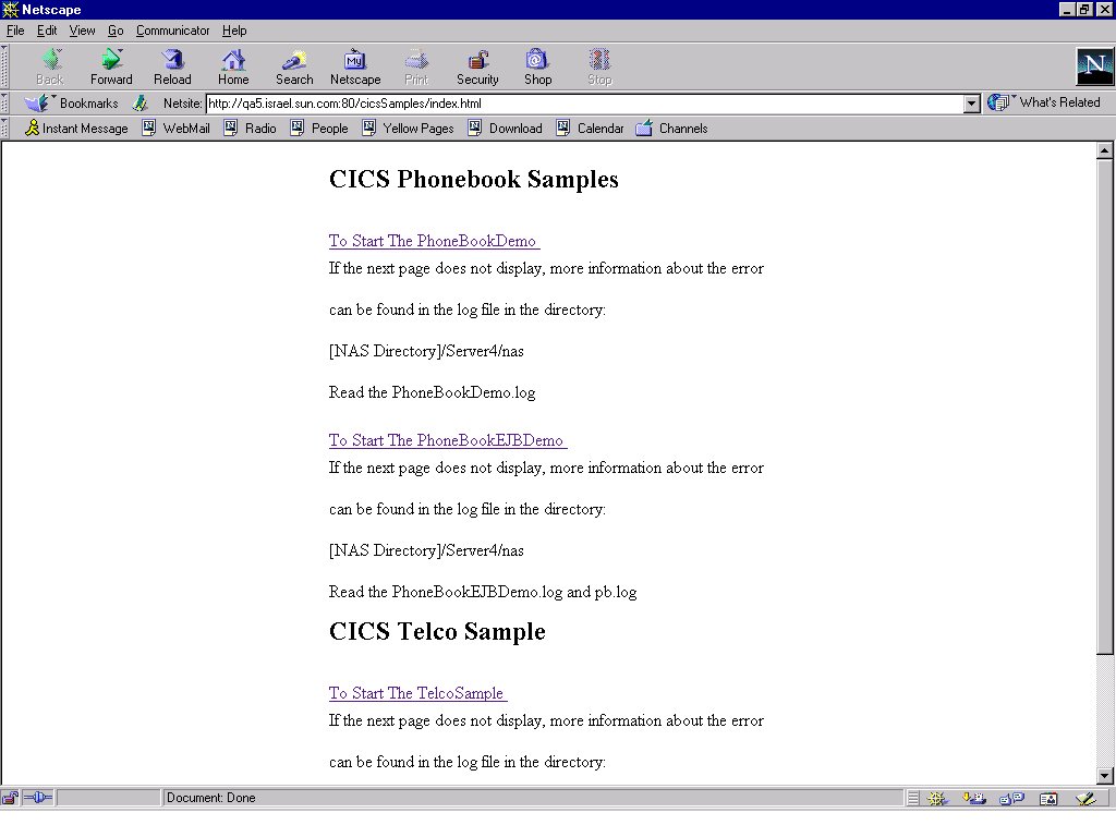

Enter the following URL:
- http://localhost/cicsSamples/index.html
Figure A-1    CICS Phonebook Sample ![]()

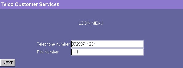

Type your telephone number and PIN number in the Login Menu dialog box, as seen in Figure A-2.
Figure A-2    ![]()

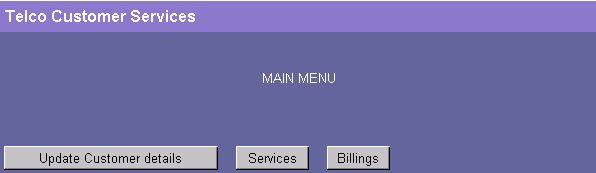

Login MenuClick Next to display the Telco Customer Service Main Menu. See Figure A-3.
Figure A-3    Main Menu ![]()

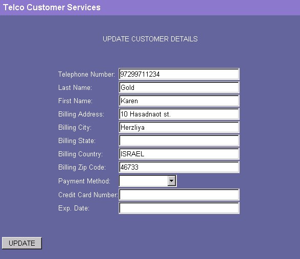

Click Update Customer Details.
- The Update Customer Details dialog box appears. See Figure A-4. This dialog box is used to update the name, address, and telephone number of the customer. The payment method, credit card number, and credit card expiration date are not displayed and cannot be changed.
Figure A-4    Update Customers Details ![]()

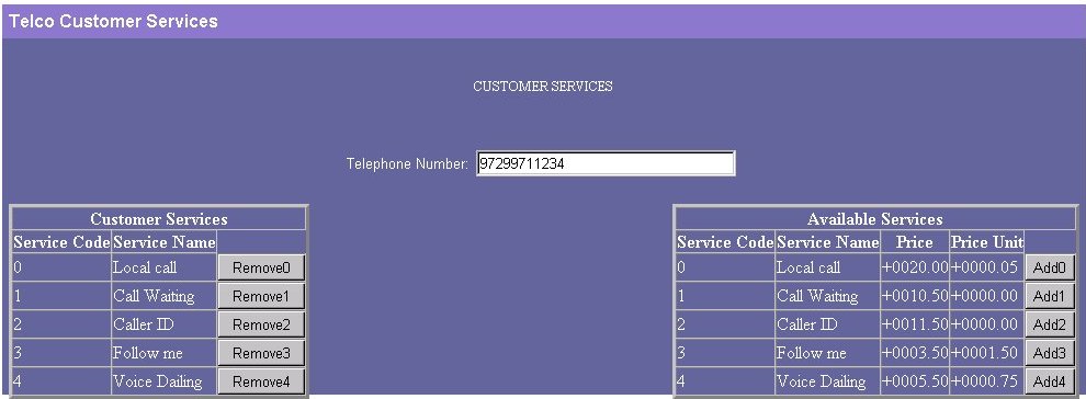

From the main menu click Services.
- The Customer Services dialog box appears. See Figure A-5.
Figure A-5    Customer Services ![]()

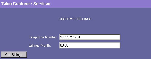

To Display the Customer's Monthly Billing

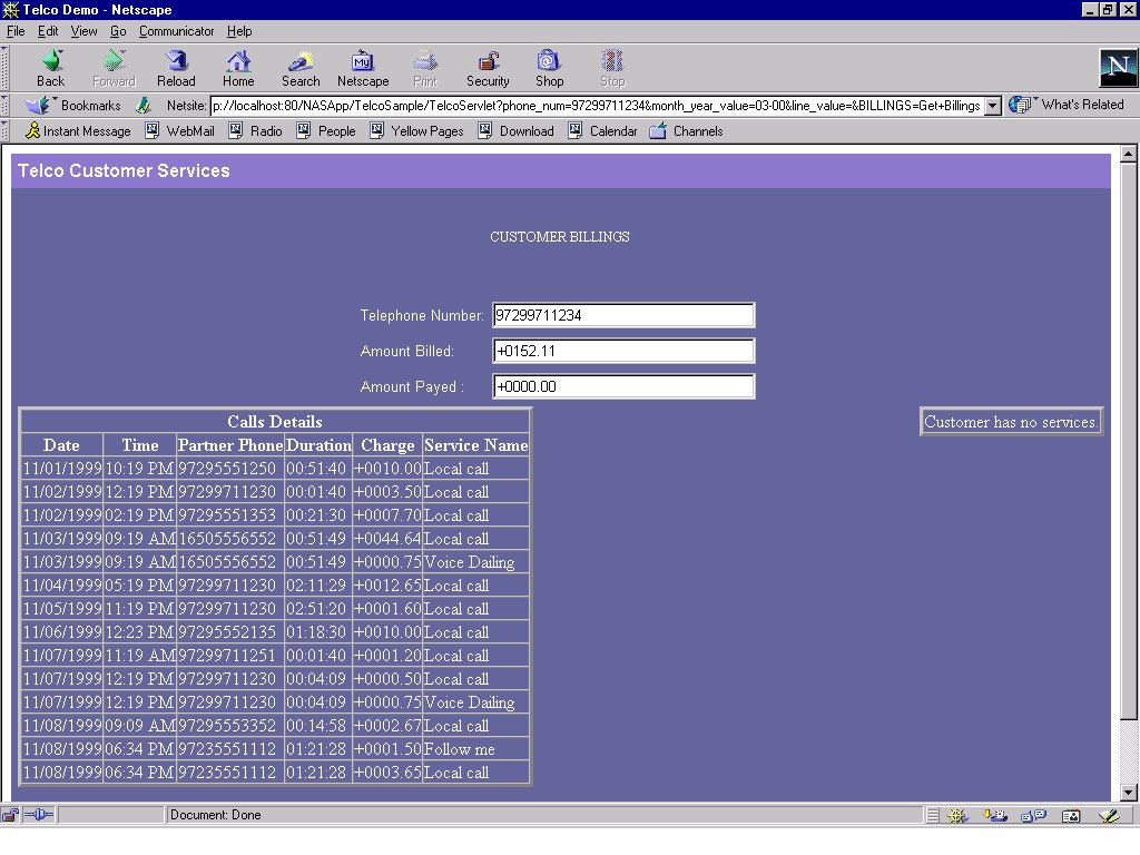

Enter the telephone number and billing month, and click Get Billings. See Figure A-6.
Figure A-6    Customer Billings Window ![]()
- The Customer Billings window is displayed, as seen in Figure A-7.
Figure A-7    Customer Billings in Browser ![]()
