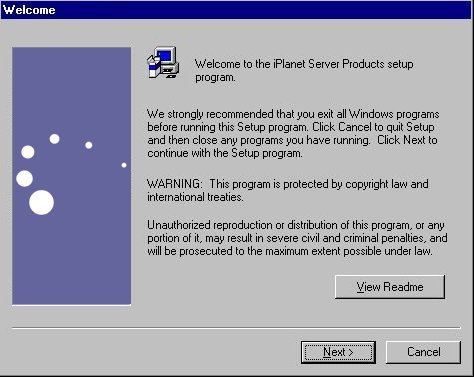

Read the Welcome message and click on the Next button. See Figure 2-1.
Follow the instructions on the screen to progress through the introduction.
Figure 2-1    Welcome Message ![]()

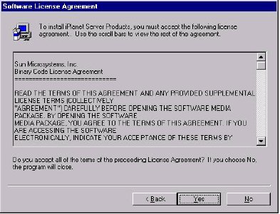

Thoroughly read and understand the licensing information before installing, and accept the license agreement. See Figure 2-2.
Figure 2-2    Software License Agreement ![]()

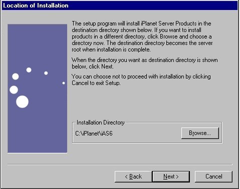

Choose your installation directory then click Next, see Figure 2-3.
Figure 2-3    Location of Installation ![]()
Note You must install the iPlanet Application Server Enterprise Connector for R/3 in the same directory where you installed iPlanet Application Server.

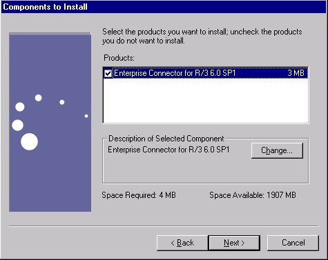

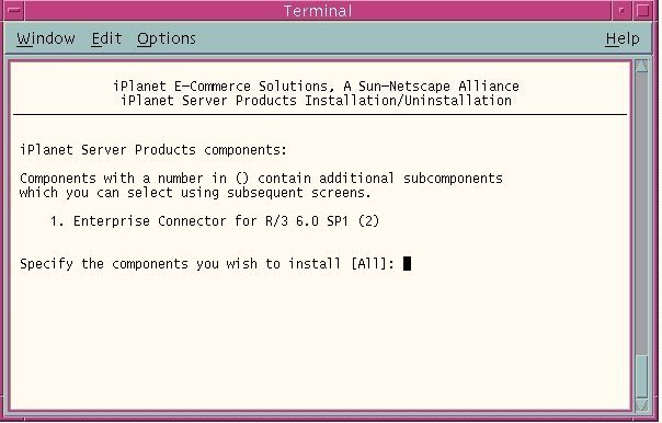

The Enterprise Connector for R/3 6.0 SP1 is selected see Figure 2-4. Click Next to continue.
Figure 2-4    Components to Install ![]()

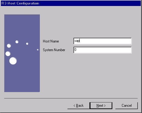

Type in your R/3 Host Name and System Number, and click Next.
Figure 2-5    R/3 Host Configuration ![]()
- The Host Name is the R/3 Application Server Host Name.

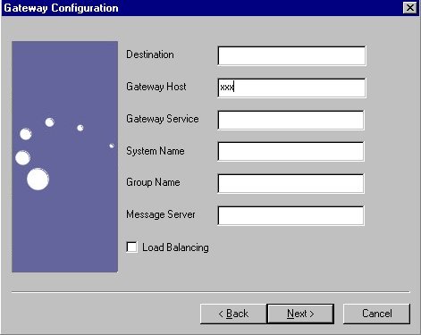

Enter the Gateway Host Configuration Parameters, see Figure 2-6, and click Next.
Figure 2-6    Gateway Configuration ![]()
- Check Load Balancing if the R/3 Server is configured to use Load Balancing. If so, you will need to enter the System Name, Group Name and the Message Server.

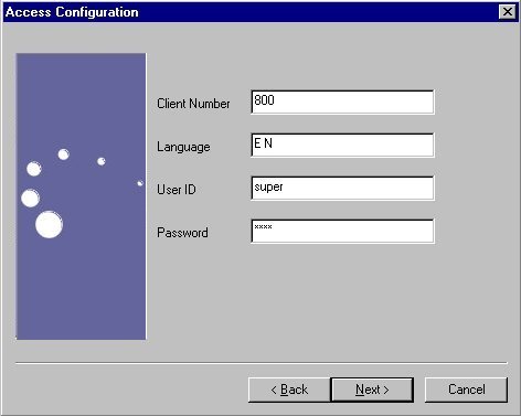

Enter the R/3 access configuration values and click Next, see Figure 2-7.
Figure 2-7    Access Configuration ![]()
Note Consult your R/3 Guide for a list of values for the Language field.

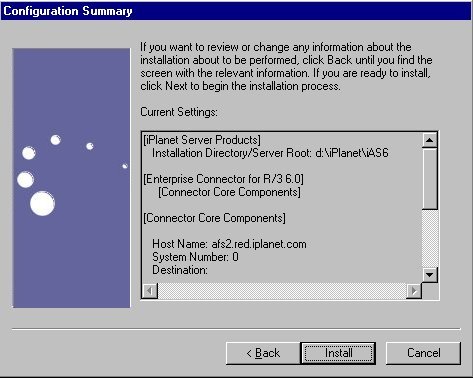

Review the configuration summary, see Figure 2-8. If it is correct, click Install.
Figure 2-8    Configuration Summary ![]()
You must restart your computer after you complete the installation.

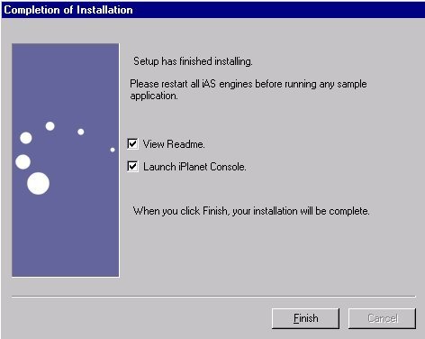

Read the Completion of Installation window which is displayed when all files are installed. Click on the Finish button. The iPlanet Application Server Enterprise Connector for R/3 is now installed.
Figure 2-10    Completion of Installation Window ![]()
- The machine must be rebooted and start the iPlanet Application Server before using the iPlanet Application Server Enterprise Connector for R/3.

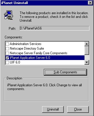

To Uninstall the R/3 Connector from Windows NT
Select Start > Programs - iPlanet Application Server 6.0 SP1 > Uninstaller. The iPLanet Uninstall Window is displayed. See Figure 2-11.
Figure 2-11    iPlanet Uninstall Window ![]()
Deselect all components for iPlanet Application Server except iPlanet Application Server Enterprise Connector for R/3, then click Uninstall.
- The uninstaller checks for dependencies between subcomponents and the main component. If you try to deselect a component and its subcomponent are toggled on, a warning message appears.

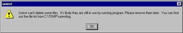

If you do not follow the order of deselection above, alert messages are displayed and you may not be able to deselect the desired option
Click Uninstall.
- A message is displayed. See Figure 2-12.
Figure 2-12    Uninstall Message ![]()
Click OK to complete the uninstallation procedure.

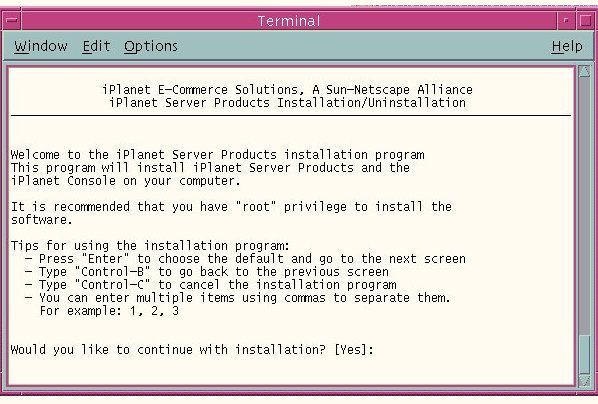

Figure 2-13 is displayed. Either press enter or type Yes to continue.
- Follow the instructions of the installation program. During installation, press the following key sequences for:
- CTRL+B to back up to the previous screen.
- CTRL+C to cancel the installation program. This results in an incomplete installation. To install again, rerun the installation program from the beginning.
Figure 2-13    Welcome Message ![]()

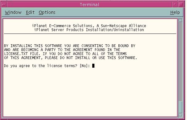

Figure 2-14    Software License Agreement ![]()
Thoroughly read and understand the licensing information before installing, and then enter Yes.

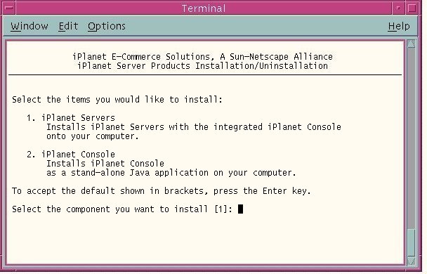

- Figure 2-15 is displayed.
Figure 2-15    Component Selection ![]()
Press Enter.

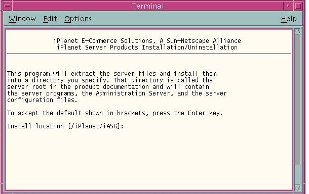

Figure 2-16    Location of Installation ![]()
To accept the default shown in the brackets, press Enter.
- Otherwise, type in the required iPlanet Application Server installation directory, and then press Enter.

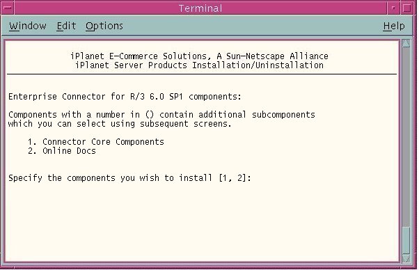

Figure 2-17    Components to Install ![]()
Press Enter.

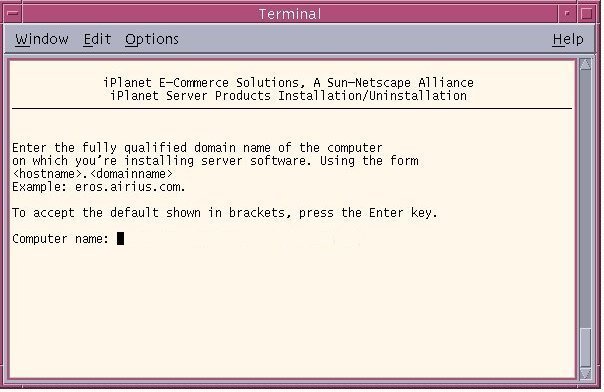

Figure 2-19    Domain Name Selection ![]()

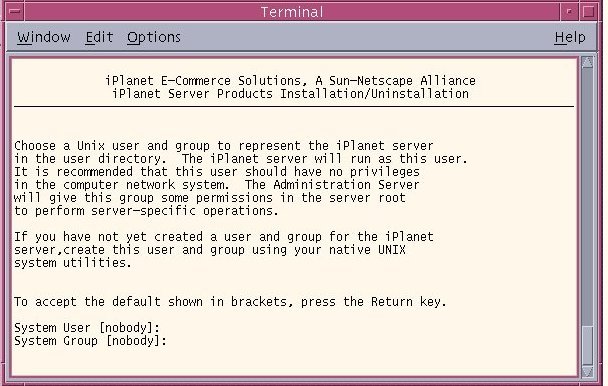

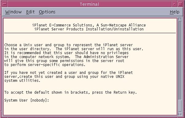

Figure 2-20    System User Selection ![]()
To accept the default shown in brackets, press Enter.
- Figure 2-21 is displayed.
Figure 2-21    System Group Selection ![]()
To accept the default shown in brackets, press Enter. Figure 2-22 is displayed. See Table 3-2 in Chapter 3 for a description of the parameters for the following screens.

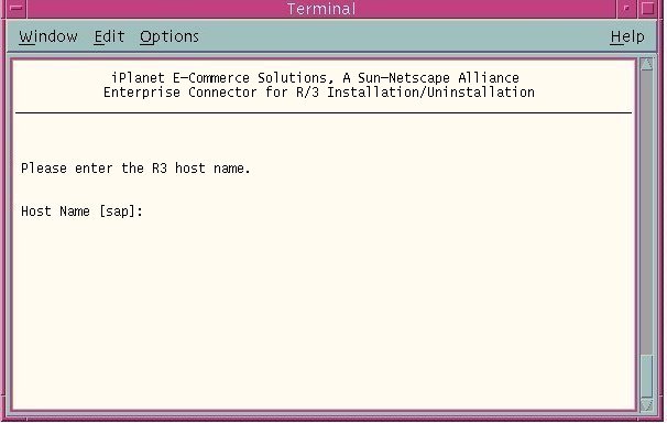

Figure 2-22    Host Name Selection ![]()
Enter the Host Name.

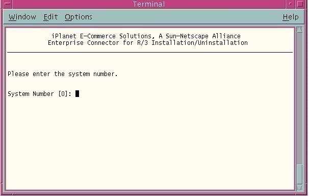

Figure 2-23    System Number Selection ![]()
Type in the System Number.

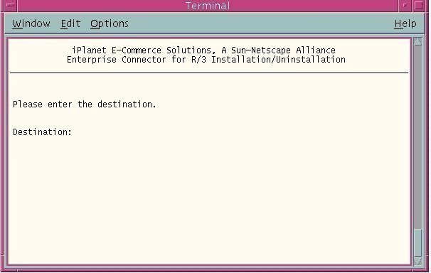

Figure 2-24    Destination Entry ![]()
Enter the destination.

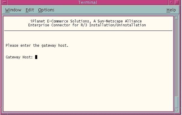

- Figure 2-25 is displayed.
Figure 2-25    Gateway Host Configuration ![]()
Enter the Gateway Host. The Gateway Host is an optional parameter.

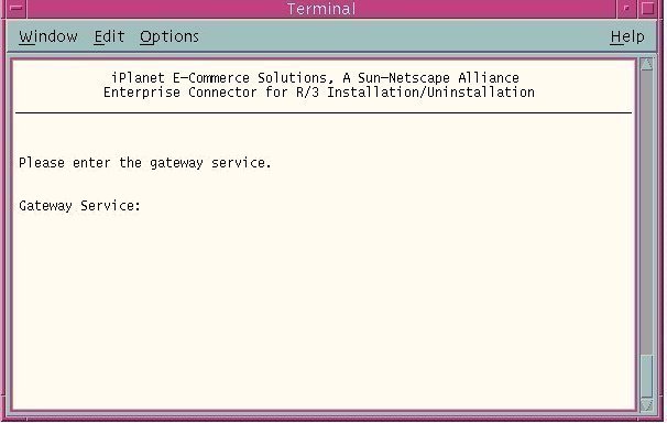

- Figure 2-26 is displayed.
Figure 2-26    Gateway Service Configuration ![]()
Press Enter or enter the Gateway Service.

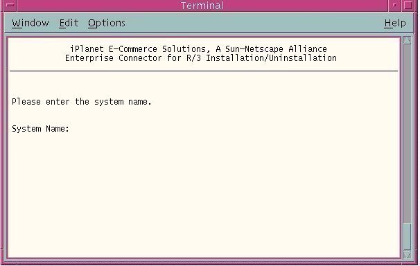

Figure 2-27    System Name Configuration: ![]()
Enter the System Name. The System Name is used for the Load Balancing option.

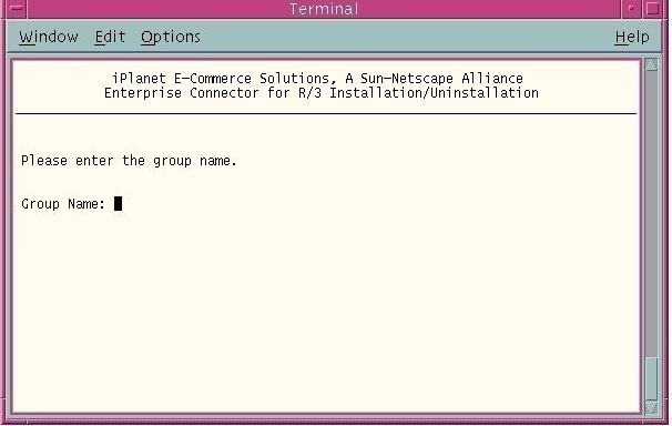

Figure 2-28    Group Name Configuration ![]()
Enter the Group Name. The Group Name is used for the Load Balancing option.

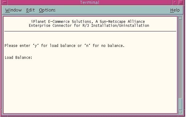

Figure 2-30    Load Balancing Option ![]()
Enter Y for Load Balancing or N for no load balancing.

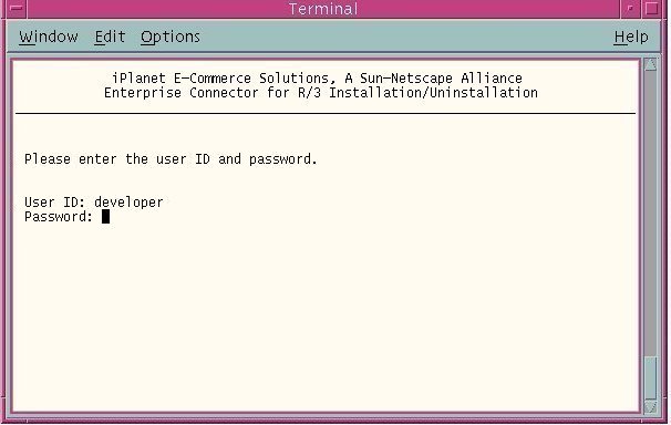

- Figure 2-33 is displayed.

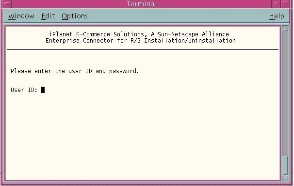

Figure 2-33    User ID Entry ![]()
Enter the User ID to connect to R/3.
- Figure 2-34 is displayed.
Figure 2-34    Password Entry ![]()
Enter the Password.

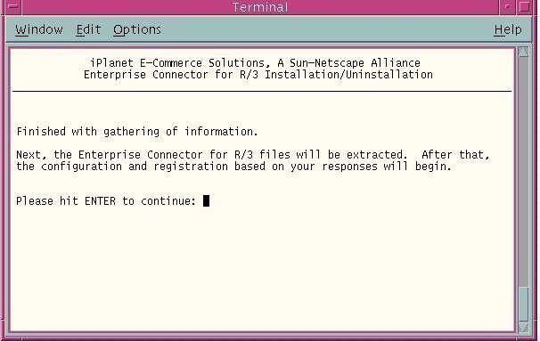

Figure 2-35    Configuration Termination ![]()
Press Enter to continue.

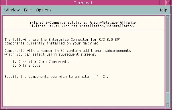

To Uninstall the R/3 Connector from Solaris
Go to the installation directory, /user/iplanet/ias6 and enter the following command:
- ./uninstall

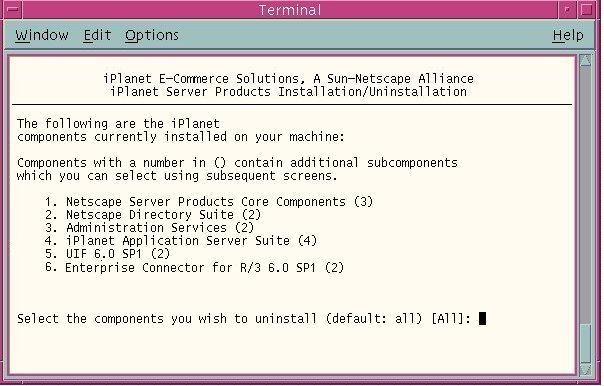

- A list of uninstall options appears. Figure 2-36 is displayed.
Figure 2-36    Uninstalling Components. ![]()
Select the specific product components you want to uninstall and click Enter. Figure 2-37 is displayed. Press Enter to uninstall all R/3 subcomponents.
Figure 2-37    Uninstalling R/3 Subcomponents. ![]()
