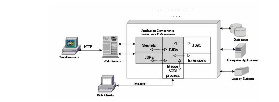

You must add a CXS (Bridge) process if Rich Clients are to communicate directly with EJBs hosted on a KJS process via the Internet Inter-ORB Protocol (IIOP). Typically, requests are made through a web path where they originate at a Web Browser and are then processed by JSPs and servlets, which in turn access EJBs. This web path uses the HTTP protocol. In the case of Rich Clients, requests are made through a Java program directly to EJBs using the CORBA Executive Server (CXS), a Java engine within iPlanet Application Server, which acts as a bridge between Rich Clients and EJBs. For more information about Rich Clients see the Developer's Guide (Java).
Figure 6-1    iPlanet Application Server Communication Architecture

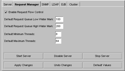

To Adjust Threads at Server Level
To adjust the number of request threads for all (KJS/KCS/KXS and IIOP) processes for a server, perform the following tasks:
  1. On the iASAT toolbar, click General to open the General window.
  2. From the left pane of the General window, select the server for which you want to adjust the number of threads.
  3. Click the Request Manager tab in the right pane of the General window.
  4. In the Default Minimum Threads text box, specify the minimum number of threads available for each process of the selected iPlanet Application Server.
  5. In the Default Maximum Threads text box, enter the maximum number of threads available for each process on the selected iPlanet Application Server.
  6. Click Apply Changes to save your changes.

To Control Request Flow at Server Level
To control the flow of requests at the server level, perform the following tasks:
  2. In the left pane of the General window, select the server in which you want to control request flow.
  3. Click the Request Manager tab from the right pane of the General window.
  4. Mark the Enable Request Flow Control checkbox to enable flow control.
  5. In the Request Queue Low Water Mark text box specify the number of requests that should be available in the queue, which will trigger request logging.
    This number is only applicable after the maximum number of requests in the queue has been reached. See the next step.
  6. In the Request Queue High Water Mark text box specify the maximum number of requests for the queue.
    When this number is reached no more user's requests will be accepted until the request queue reduces to the number specified as the low watermark.
  7. Click Apply Changes to save your changes.

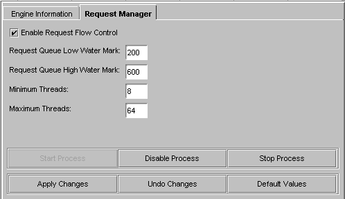

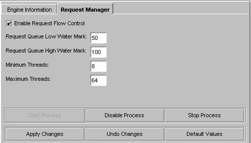

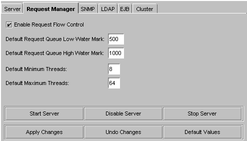

To Control Request Flow at Process Level
You can also customize the request flow for a process. Note that the numbers you specify for a process will be accepted as default for that process. The process level setting overrides the server level setting
To adjust the request flow for a process, perform the following tasks:
  2. In the left pane of the General window, select the server for which you want to control request flow. Expand the server to view its processes.
    Note You can expand a server in the hierarchical tree only when it is running.
  4. Click the Enable Request Flow Control checkbox to enable flow control.
  5. In the Request Queue Low Water Mark text box enter the number of requests in the queue in which logging will resume.
  6. In the Request Queue High Water Mark text box enter the maximum number of requests for the queue.
    These setting override the default settings at the server level.
    Note Settings that are specified at process level override those set at the server level.

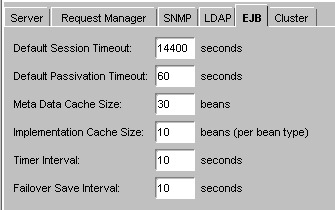

To Specify EJB Container Parameters for Run Time
iPlanet Application Server provides an EJB container that enables you to build distributed applications using your own EJB components, and components from other suppliers. When you configure iPlanet Application Server for your enterprise, you must set the EJB container's declarative parameters. These parameters determine, for example, session timeout when an EJB is removed after being inactive for a specified number of seconds. Set these parameters using the editor in iASAT.
To access the editor, perform the following tasks:
  2. In the right pane of the General window, click the EJB tab to open the EJB container declarative parameters editor.
    The following window appears:
    The editor allows you to set the following values:
    • Default Session Timeout
      If an EJB is not accessed for the specified number of seconds, it is removed. This applies to stateful session EJBs.
    • Default Passivation Timeout
      Time (in seconds) that elapses before the state of the EJB is written to disk. This value must be less than the session timeout value.
    • Metadata Cache Size
      The metadata cache for EJBs, whose value is in number of EJBs.
    • Implementation Cache Size
      Maximum cache size is in number of EJBs.
    • Timer Interval
      How frequently (in seconds) the EJB pool checks to see if it should passivate or remove an EJB.
    • Failover Save Interval
      How frequently (in seconds) the EJB state is saved. If the server fails, the last saved state of the EJB can be restored. Data saved is available to all engines in a cluster. This value is set on a per server basis and applies to EJBs that were deployed with Failover option enabled (on the General tab of the Deployment Tool EJB descriptor editor).
  3. Click Apply Changes to save your changes.
  4. Restart iPlanet Application Server for the changes to take effect.

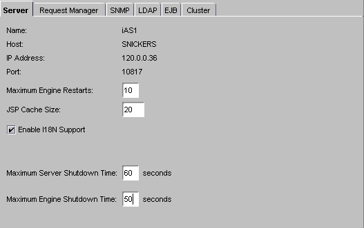

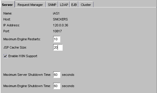

To Specify Maximum Number of Engine Restarts
When a process, such as Executive Server (KXS), Java Server (KJS), C++ Server (KCS) or Corba Executive Server (CXS) fails, the Administrative Server restarts it. You can set the restart option to either increase or decrease the number of times that a process is restarted. Fault tolerance and application availability are increased when all processes are running smoothly.
To adjust the restart option of the Administrative Server, perform the following tasks:
  2. In the left pane of the General window, select the iPlanet Application Server instance whose Administrative Server restart option you want to adjust.
  3. Open the Server tab from the right pane of the General window.
  4. Specify the new restart value in the Maximum Engine Restarts text field.
  5. Click Apply Changes to save your changes.
To Enable Internationalization Support
You can enable iPlanet Application Server to support applications in languages belonging to different geographic locations.
To enable internationalization, perform the following tasks:
  2. In the left pane of the General window, select the iPlanet Application Server instance for which you want to enable internationalization.
  3. Click the Server tab in the right pane of the General window.
  4. Mark the Enable I18N Support check box.
    Note You must stop and restart the server for your changes to take affect. See Performing Administrative Tasks Using iPlanet Registry Editor for information.
To Cache JavaServer Pages (JSP)
You can specify the number of JSP pages that are cached by each KJS engine for each iPlanet Application Server instance. Caching JSPs optimizes application response time.
To set the JSP caching value of the Administrative Server, perform the following tasks:
  2. In the left pane of the General window, select the iPlanet Application Server instance for which you want to set the JSP caching value.
  3. Click the Server tab from the right pane of the General window.
  4. Specify the JSP Cache Size in the text field. The cache size is set on a per-page basis.
To Specify Maximum Server and Engine Shutdown Time
You can set shutdown values of the Administrative Server for both iPlanet Application Server and engine processes. For example, if you set a 60 seconds engine shutdown time, application tasks being processed are allowed 60 seconds for completion. No new requests are accepted after this period has elapsed. Specifying a shutdown value avoids a "hard" shutdown that will return errors to the client.
To set the server and engine shutdown time of the Administrative Server, perform the following tasks:
  2. In the left pane of the General window, select the iPlanet Application Server instance whose shutdown time you want to specify.
    Specify a Maximum Server Shutdown Time.
    The Maximum Server Shutdown Time is the maximum time taken to shut down iPlanet Application Server. After this time, any engines that are still running are killed. The server typically shuts down quickly unless it is heavily loaded.
  4. Enter a Maximum Engine Shutdown Time.
    The Maximum Engine Shutdown Time is the maximum time that iPlanet Application Server will wait for an engine to shut down. After this time, the engine will be killed, and the next engine(s) will be shutdown.

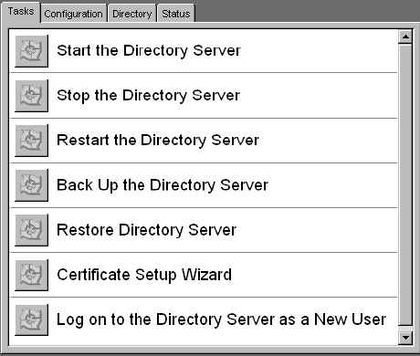

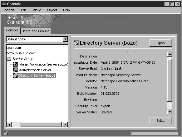

  1. Start Netscape Console (on the machine in which the backup Directory Server is installed).
    On Windows systems, you can do this by opening the Start menu, and choosing Programs>iPlanet Server Products>Netscape Console 6.0.
    On both Windows and Solaris systems, navigate to the <iASInstallDir> path, and type startconsole at the command line prompt.
  2. Double-click Directory Server, as shown in the following figure:
    The Netscape Directory Server opens, as shown in the following figure:

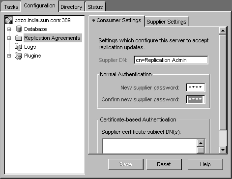

  4. Select the Replication Agreement folder as shown in the figure.
  5. In the Consumer Settings tab, provide a valid Distinguished Name in the Supplier DN text field, for example, cn=Replication Admin.
  6. In the New supplier password text field, enter a password of your choice. You will be prompted for this password during supplier authentication. Confirm your new password in the Confirm new supplier password text field. Note that your password must be at least 8 characters long.
    If you want certificate based authentication, enter the Distinguished Name of the supplier certificate that you want to use for authentication, in the Supplier certificate subject DN(s) text box.
    Note For more information on certificate based authentication, see the chapter "Managing Replication," in the Netscape Directory Server Administrator's Guide. This document is installed with your installation of Directory Server in the following location:
    <iASInstallDir>/manual/en/slapd/ag/replicat.htm
  7. Click Save. The backup Directory Server is now ready for replication.

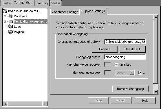

  2. Before you begin the replication, you need to set the primary Directory Server's changelog database directory. This is the directory where all the changes made to the directory server's settings are logged. You must set this directory to ensure that replication takes place.
    To set the changelog directory, perform the following tasks:

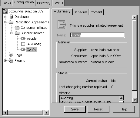

    1. In the Directory Server main window, open the Replication Agreements folder, as shown in the following figure:
    2. In the right pane of the window, click the Supplier Settings tab.
    3. Specify the changelog directory in the Changelog database directory text field. Click Browse to locate a directory, or click Use default to set the default changelog directory.
    4. Click Save to save your changes. You can now continue with the replication.

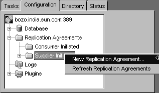

  3. Expand the Replication Agreements folder to its hierarchal tree. Right-click on Supplier Initiated Agreements, and select New Replication Agreement, as shown in the following figure:

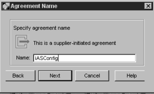

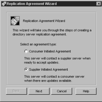

  4. The Replication Agreement Wizard opens. Select Supplier Initiated Replication, as shown in the following figure:
  5. Click Next. In the Agreement Name window, specify a name (any string value) for the supplier-initiated agreement, as shown in the following figure:

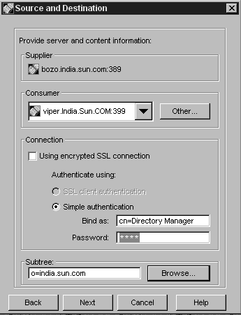

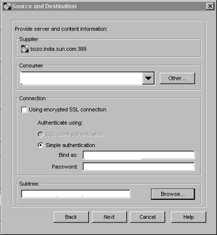

  6. Click Next. The Source and Destination window opens, as shown in the following figure:
  7. In the Consumer text field, enter the hostname of the machine on which the backup Directory Server is installed.
  8. Click Other. The Consumer Server Information popup window opens, as shown in the following figure:
  9. In the Host name text field, provide the host name of the machine on which the backup Directory Server is installed.
  10. In the Port text field, provide the Port Number, if it is different from the primary Directory Server machine's port number.
  11. Click OK to confirm. You can now see the consumer name in the Source and Destination window.
  12. Select Simple authentication, for simple and direct authentication.
    Note If you want a higher level of security, you can choose encrypted SSL connection. If you choose this option, the user will be authenticated through a Secure Socket Layer (SSL) process. You will need to specify the subject DN of the certificate server. For more information, see
  13. Provide a valid Distinguished Name in the Bind as text field, using which the Primary Server will bind to the backup Directory Server.
  14. In the Password text field, provide the password that you used during iPlanet Application Server installation.
    Note You can have multiple instances of iPlanet Application Server on a Solaris system. Ensure that the password you provide pertains to the iPlanet Application Server instance for which you are configuring a backup Directory Server.
  15. In the Subtree field, provide the name of the directory tree that you want to replicate. Click Browse to view a list of the existing trees and subtrees in the primary Directory Server. The following window appears:
  16. Select the first directory tree to be replicated. You can select either X=YourDomainName or Y=iASCluster. In the example, X=YourDomainName (india.sun.com) has been chosen.
    To choose Y=iASCluster, expand the NetscapeRoot folder and select iASCluster.
  17. Click OK to confirm replication of the directory tree in the backup Directory Server.
    Note When you replicate X=YourDomainName, make sure that you replicate all the domain names that are stored in your primary Directory Server, to enable proper authentication during failover.
    The subtree that you selected appears in the Subtree text field of the Source and Destination window.

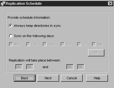

  18. Click Next. The Replication Schedule window appears, as shown in the following figure:
  19. Select Always keep directories in sync, to keep the data current in both Directory Servers.
    Select Sync on the following days if you want to schedule the data synchronization between the primary and backup Directory Servers. Data replication will occur during the period you specify on the selected days of the week.
    Click All if you want to schedule data synchronization on all days of the week.

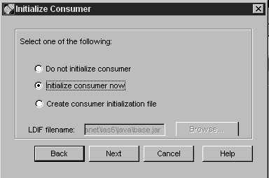

  20. Click Next. The Initialize Consumer window appears, as shown in the following figure:
  21. Select the Initialize consumer now radio button. This option initializes the backup Directory Server immediately. The backup Directory Server is ready for replication.
    Select Do not initialize consumer to stop replication at this point. If you choose this option, data is not replicated in the backup Directory Server.
    Select Create consumer initialization file if you want to write the data to a file. Select a .ldif file for storing the data, which can be copied to the backup Directory Server later. See Using LDIF to Add Entries to Directory Server, for more information.

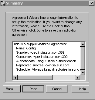

  22. The Replication Summary window appears, as shown in the following figure:
    After viewing the summary, click Done. The replication agreement is created. The backup Directory Server is initialized and is populated with the primary Directory Server data.

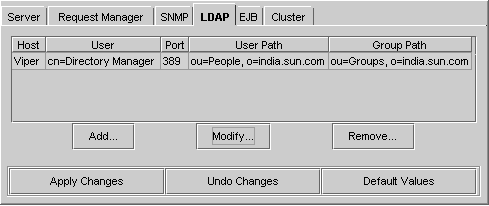

  2. Select the iPlanet Application Server instance for which you want to configure a backup Directory Server.
  3. Open the LDAP tab from the right pane of the General window. The following window appears:
Directory Server(s) associated with your iPlanet Application Server instance appears in this window.

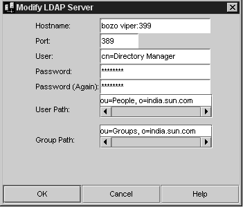

  1. Select the primary Directory Server and click Modify. The following dialog box appears:
  2. In the Hostname field, insert a space after the existing hostname and enter the name of the machine on which the backup Directory Server is installed (as shown in the figure given above). If the port number of the backup Directory Server machine is different, insert a colon (:) next to the hostname and specify the port number, for example, bozo viper:399
    You need to specify the port number only if it is different from the port number of the host.
  3. Click OK to close the window.
  4. Click Apply Changes to register the changes in iASAT.
  5. You need to stop and start iPlanet Application Server for the change to take effect.

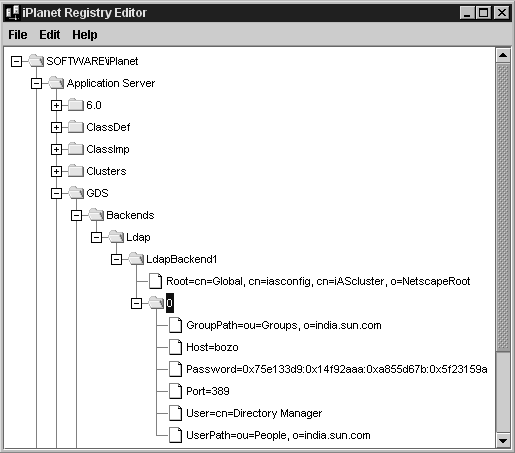

  1. Start iPlanet Registry (on the machine where the web-connector is installed).
    (See About iPlanet Registry Editor).
  2. Open the following key:
    SOFTWARE/iPlanet/Application Server/GDS/Backends/Ldap/LdapBackend1/0/
  3. Select the Host=<hostname> value. Double-click the value to open it, or choose Modify Value from the Edit menu. The Modify Value dialog box appears, as shown in the following figure:
  4. Insert a space after the existing hostname and enter the name of the machine on which the backup Directory Server is installed (as shown in the figure). If the port number of the backup Directory Server machine is different, insert a colon (:) next to the hostname and specify the port number.
    For example, bozo viper:399
    Stop and start iPlanet Registry for the changes to take effect.
