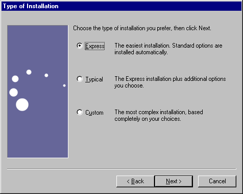

Choose the type of installation and click Next.
- Select the iPlanet Administration Console to install it as a standalone application. Selecting the iPlanet Server and core components will install the Administration Console by default on the same machine on which you are installing the application server.
For information on Custom installation, see Chapter 5 "Advanced Installations for Windows."

Select Express as the type of installation to perform and click Next.

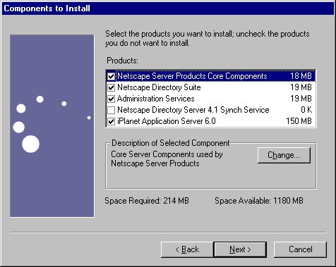

Click Next to accept the default choices on the Components to Install panel. The default choices indicate those installed during a full installation.
- Click the Change button to further refine your choices. This displays the subcomponents associated with each component selected.
- Your selections at the component level of the Components to Install panel enable you to:
Deselect the Directory Suite component if you already have a directory service available.
Deselect Administration Services if you don't want the iPlanet Administration Console.
- Do not select the Netscape Directory Server 4.1 Synch Service. It's better to configure it after installation.
- iPlanet Application Server bundles the PointBase database server, which is installed by default. If you do not want to install PointBase, select iPlanet Application Server 6.0 > Change, and uncheck the box next to PointBase Database Server.
- The Configuration Directory Server is the part of the Directory Server used to store configuration information. The Directory Server also stores directory data. For an overview of the various functions of the Directory Server, see the iPlanet Directory Server Installation Guide.

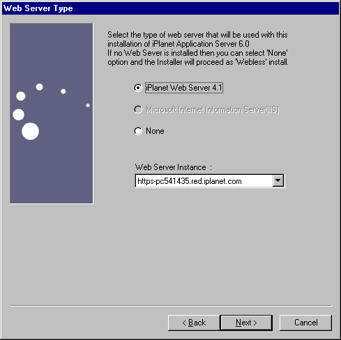

Select the type of Web Server installed. If you have multiple Web server instances running, then select one from the drop-down menu to locate an instance to associate with iPlanet Application Server.

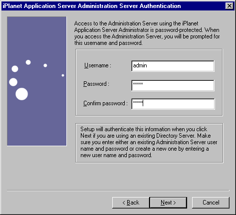

Enter an Administrator Username and Password. This sets up the user name and password for the iPlanet Administration Server Console.
- Select None if you do not have a Web server installed. This causes iPlanet Application Server Installer to continue without installing the Web Connector plug-in. This is referred to as a "webless" installation. For more information, see "Installing the Web Connector Plug-in" on page 160.
Note The Webless type of installation is necessary if your Web server is installed on a remote machine. After you are finished installing iPlanet Application Server, you must go to that machine and install the Web connector. For more information, see "Installing the Web Connector Plug-in".

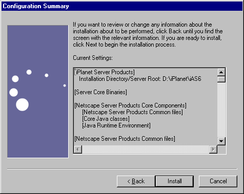

Click Install to complete the installation.
- The Configuration Summary screen with all your settings will now be displayed.
- If you want to change any of the settings, click Back to page back through the panels and correct them.

Select Typical as the type of installation to perform.

Click Next to accept the default choices on the Components to Install panel. The default choices indicate those installed during a full installation. Click the Change button to further refine your choices. This displays the subcomponents associated with each component selected.
- If you have deselected the directory suite component, you will be prompted to enter the location of the configuration directory.

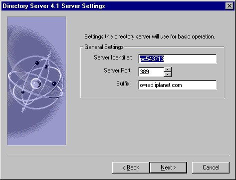

These settings consist of an identifier for the Directory Server's host machine, the port number of the LDAP communication port, and the data information tree suffix that is used to identify the root of the database tree for this iPlanet Application Server installation or the Directory Server.To use an existing Directory Server for data storage, select that option and enter its general settings:
Specify the Directory Server's General Settings
The suffix is the entry at the top of the Directory Server data tree, below which iPlanet Application Server data is stored. For more information on standard directory suffixes, see the iPlanet Directory Server Administrator's Guide.
The Server Identifier is set to the local host (the computer on which you are installing the directory server.)
The default Server Port number is 389 (the standard LDAP port number); if the port is in use, a randomly generated number will be used.
The default domain name is set to the computer you're installing the Application Server on.

Indicate the Web Server type (which has been installed earlier), by choosing one of the following:
iPlanet Web Server
Enter the user name and password for the iPlanet Administration server. Click Next.Microsoft Internet Information Server (IIS)
None. In this case a Webless installation take place. After you have finished with this installation you must install the Web Connector Plug-in. for more information see, "Installing the Web Connector Plug-in".
- The Configuration Summary panel appears.

The next screen allows you to choose the installation type. The Express Installation is described next. For a description of the typical installer, see "Running the Typical Installation" on page 78.Insert the product CD in the CD-ROM drive.

Enter 1 to select Express Installation.

On the iPlanet Server Products Components panel, the default choice of [All] indicates which components are installed during a full install of iPlanet Application Server. You may choose to:
- If you enter a different location, do not include spaces in the path name.
Note You must have at least 400 MB available on this drive to install. All components are installed in this directory
Keep the default selection. If you choose [All], the sub-components of the selected components are listed in subsequent screens, so that you can further refine your choices.
Type in the system user and group names.Enter 1,3,4 to not install the Directory Suite component if you already have a directory service available.
Note The Directory Component should not be selected if you intend to install multiple instances of iPlanet Application Server. See "Installing Multiple Instances on Solaris" for more information.
Enter 1,2,4 to not install the Administration Services component if you don't want the iPlanet Administration Console.
Enter 4 to install only the iPlanet Application Server.

Enter a user name and password for the iPlanet Application Server's Administration Server.
- The iPlanet Application Server Web Connector Plug-in will now be installed and configured to the Web Server instance that is identified here.
Note Record the username and password. After installation, you'll need them to register iPlanet Application Server with the iPlanet Application Server Administration Tool.

Enter 2 to select the Typical Installation type.

Press Enter to set the listener port for the Directory Server by default to the standard port number: 389. For more information, see "Configuring Port Numbers" on page 153, in Appendix A.
- Enter Yes to register with an existing directory server. You will be prompted for the host, port, suffix, and bind DN to use for that directory server.
Press Enter to set the unique identifier for the Directory Server by default to the name of the computer it's being installed on.
Assign the Administrator ID and password for the configuration directory.
- To enter a different name type the name and press Enter.
Press Enter to accept default username as admin,or type in a username and press Enter.
Enter the data information tree suffix for your organization.Enter a password; it can contain letters and numbers.
Enter a distinguished name (DN) for the directory server's administrator. The default value is Directory Manager (cn=Directory Manager).
- For example, if an organization uses the distinguished name service (DNS) of iplanet.com, then a reasonable suffix for identifying that organizations' data is: o=iplanet.com.
Enter the directory server's Administration Domain.
- Enter a password for the Directory Manager that is at least 8 characters long.
- The Directory Manager's Distinguished Name is the special directory entry for the administrator of the Directory Server. Access control does not apply to the Directory Manager.
Set the port number of the iPlanet Administration Console's administration server. By default it is set to a random unused port number between 1024 and 65535. For more information, see "Configuring Port Numbers" on page 153, in Appendix A.
- The default is set to the installation computer's domain. If you need to change this value, you should use a name that corresponds to the organizations that control the servers in each domain.
- As a Directory Server may store Configuration information for multiple domains, the Administration Domain is used to keep these separate. Enter an administration domain to use for keeping software configuration information stored in the Configuration Directory Server distinct from other such information.
- The Directory Server is now configured for installation.
