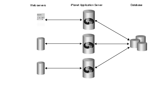

Hosting Applications Locally on Multiple Servers
Hosting applications locally on multiple servers is the simplest of the three most common server configurations. In this configuration, you deploy the complete application on each iPlanet Application Server machine. If the application is already installed on an iPlanet Application Server machine, you can use the Deployment Tool to deploy the application to other servers.This configuration requires that you configure each web connector plug-in to forward requests to the appropriate iPlanet Application Server machine.
Alternatively, it is possible to deploy local applications across multiple iPlanet Application Server instances while sharing a common web server and LDAP server. This configuration functions much like the first example, except that there is a single web server, and all iPlanet Application Server instances share a common configuration through the same LDAP server. This configuration has the advantage in that load balancing can be done across multiple iPlanet Application Server instances whereas the prior example requires clients to access multiple different web servers. While this scenario is possible, it may or may not be suitable for your particular application.

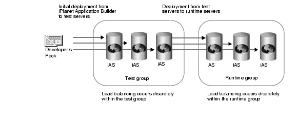

Balancing application-request loads, or load balancing, differs from partitioning applications. Load balancing requires you to place one or more copies of an application component on multiple iPlanet Application Server machines rather than simply dividing an application's components among multiple servers (or partitioning the application). You then configure each server, allowing it to find application components on other servers.When you deploy an application, you must decide if you want to configure the application for load balancing and, if so, how you will configure it. Choose among the following load balancing configurations:
Balancing loads only between the servers in a production environment, if deploying to more than one iPlanet Application Server machine.
The following illustration depicts a load-balancing distribution as discussed in the Example 1:
Balancing application loads between existing production servers and new servers that you add to the enterprise.
- Example 1: You might have three iPlanet Application Server machines used for testing applications. Your production environment, where users' requests are actually processed, also consists of three iPlanet Application Server machines. Because the application components could be different between the two groups of servers, you do not want to enable application load balancing. Therefore, when you deploy an application from the test servers to the production servers, you should choose only to balance the loads between the destination servers.

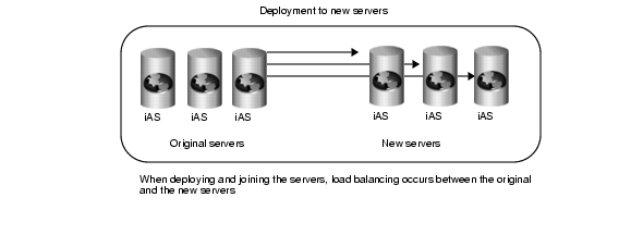

- Example 2: Suppose you scale the enterprise to include three more iPlanet Application Server machines in the production group, you can join all the servers in that group when deploying the applications from one of the existing production servers to the new servers. The application loads are then balanced between the existing servers and the new servers. (Scenario 2)
The next illustration depicts a joining of servers when adding new servers to a group and deploying an application to those servers with the join option as discussed in Example 2.

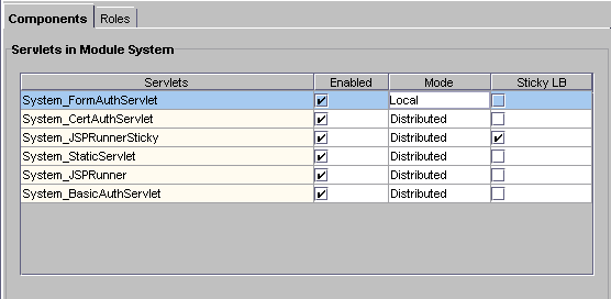

Changing Attributes of Distributed Application Components
When you change such attributes as enabled sticky load balancing for an application component that is distributed across multiple servers, those changes replicate themselves on the servers where that component is hosted. Changing the distribution level (local, distributed, and global) of installed application components is useful if you previously installed an application locally, but now want to distribute the application for load balancing. You can also disable load balancing by changing a distributed application to a local configuration on the specified server.If you change a component from a distributed or global state to a local state on one server, each server that hosts that component ceases to balance loads with the server where the distribution was set to local.
For example, an application component called ShopCart is distributed across servers A, B, and C. Should you decide to run ShopCart locally on server A, but continue to allow it to run in a distributed state across servers B and C, each server (A, B, and C) is automatically updated so that requests for ShopCart are no longer passed to server A from servers B and C. Instead, requests for ShopCart made to servers B or C are passed only between those two servers. All requests for ShopCart made to server A are processed only by server A.
To change the distribution level for an application component, perform the following steps:
Open the Application window of iASAT.
In the left pane of the Application window, expand the server for which you want to change application settings.
Expand the application folder and select the servlet or AppLogic icon that contains the application components you want to modify.

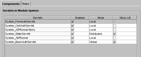

In the right pane of the Application window, select each application component for which you want to change the distribution level as follows:
Local--The servlet or AppLogic runs on one iPlanet Application Server machine only
In the Mode column, change the distribution level.Distributed--The servlet or AppLogic runs on specified iPlanet Application Server machines
Global--The servlet or AppLogic runs anywhere in the enterprise.
If you are changing the distribution level for all components in the selected group, click Toggle Mode. All application components are updated simultaneously.
In the left pane, under Registered Servers, choose which iPlanet Application Server machines will participate in load balancing of the selected application component. The application component must be installed on each iPlanet Application Server machine participating in load balancing.If you are modifying the Mode from Local to Distributed or Global, you must modify the application properties to specify across which iPlanet Application Server machines load balancing is to occur.
If you are modifying the Mode from Distributed or Global to Local, there is nothing more you need to do.
- When you change an application component's Mode to Distributed all registered servers appearing in the left pane of the Application window are added to that application component's server list. You can access the server list by clicking Application Component Properties.
If you need to register additional application servers, go to the File menu and choose New, then choose Server.
Repeat these steps for each application component.
Click Apply Changes to save your changes to the iPlanet Application Server machine.
